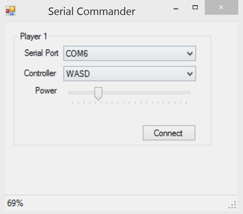

For Windows with Bluetooth built in or a Bluetooth dongle, you can download Serial Commander, a small program that lets you control your bot with the standard WASD keys.

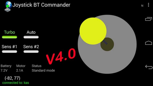

For Android users you can download the app Joystick Bluetooth Commander from the play store. This will allow you to use a touch joystick style interface.

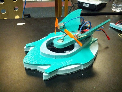

Step 2: Glue the Foam Pieces
The Plenum Chamber is often the body of the hovercraft. This is where the air that the lift fan blows in gets distributed so that it may equalize before venting out below to provide lift for the hovercraft.
The foam we use can be found in the insulation section of your regular large DIY store. We have three thicknesses in this design: 1/4", 1/2", and 3/4". Usually only one side of the foam insulation has markings. Pay attention to which side of each piece of foam will be on the outside of the finished hovercraft so you can hide the markings.
Line up the plenum skirt piece (or pieces) with body/plenum top and place a thin line of glue around the perimeter of the body and the perimeter of the electronics bay (rectangle), but NOT the fan circle.
Line up the parts using corners as a guide and use toothpicks to hold the parts and prevent them from slipping and sliding while the glue dries.
Step 3: Glue More Foam Pieces and Decorate
This really one of the more time consuming pieces of the build. There is a lot to glue together. Take your time, and line things up. Don't let air leak out. Make sure that the fan blades aren't going to hit the foam due to bad alignment. And...
Decorate. As you're putting these parts on you can use markers, glitter glue, tape, whatever to make your hovercraft your own. Watch the weight though, you do want it to get off the ground. But this is a good time to personalize since some of the parts will be difficult to reach once other parts are glued down. And still other parts, like the top plate are a wee bit fragile after you glue them down, but they're very easy to work with alone on a flat surface
Keep building up the hovercraft in layers. The technique remains essentially the same. Put a thin line of glue around the perimeter of the smaller piece and if available some glue in where firm contact will be possible.
You can glue the the alignment shafts (an arrow shaft cut down to size) to the plenum (but NOT higher up than the fan duct), and use it to help align the pieces as you glue them in place.
You will definitely need to use toothpicks on the fins/wings. And a tiny bit of hot glue helps things set up in short order.

Hot glue the two drive motors onto the front of the fins and Press fit the Lift motor into the bottom side of the motor mount and you should be good to go.
Step 6: ​Stuff It All Together
Place the electronics package into the electronics bay in the hovercraft body. Make sure the battery wire is easily accessible and everything else is out of the way. Make sure that you can also fit the battery into the electronics bay as well. You may have to fiddle to get everything in with the wires and all, but be gentle, the foam and glue can only take so much stress.
Slide the Fin Assembly/electronics bay cover over the electronics bay leaving the battery connectors out and accessible. Make sure the Lift Fan is centered in the fan duct with good clearance all around and then secure with a two pair of tooth picks (two each - front and back) angled at 45 degrees into the thick plenum skirt layer (not just the plenum top plate). Make sure the Fan Mount doesn't slide out of position and allow the Lift Fan Blade to contact the sides of the Fan Duct (if it hits and gets stuck it will quickly burn out the motor).

You have a couple of choices at the moment for remote control. Our favorite way to control Bluetooth RC vehicles is the android app Joystick Bluetooth Commander. This free and open source app allows you to configure and send may commands to your RC vehicle. We'll only be using simple X and Y controls for hovercraft, but it's a great general purpose Bluetooth RC app, and since it's open source you can change it to meet your needs. There is also a bit of documentation and support available on the developers forum site. Just install the app and pair with Bluetooth like normal. The HC-05 modules will naturally report with the ID HC-05. If you happen to be in a room with several hovercraft you may need to look at the MAC Address of the HC-05 module to figure out which one to pair with. After pairing you can connect the app and use the joystick to drive the hovercraft. Practice makes perfect.
Also available is a custom coded Windows program (just for this hovercraft project) Serial Commander supporting a basic keyboard control over Bluetooth using the same protocol as Joystick Bluetooth Commander. It's a bit more basic for the moment, but it will allow anyone with a PC and a Bluetooth dongle to connect and control their hovercraft. Just download the program and run the setup and pair to your Bluetooth module as above. You will need to know which COM Port Windows has selected to use for this Bluetooth connection. Open Device Manager and select COM Ports. It should be the last one added (sometimes windows adds COM Ports in pairs, so it may be one of the last two - failing that you can always just try them all). Select the appropriate COM Port in Serial Commander and set the strength slider to a mid value and then use the WASD keys to control your hovercraft.
