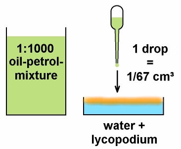

The next step is to determine the volume of a drop from the pipette. To do this, fill the pipette with petrol and then drip into an opened 1 ml syringe until it is full. Specifically, I needed 67 drops from the pipette until the 1 ml syringe was full. Therefore 1 drop from the pipette has a volume of 1/67 cm³.
Now fill the baking sheet about 1 cm high with water. The bear moss spores are filled into a plastic jar with a screw-on lid. This lid is poked about 5-10 times with a thin needle. Then sprinkle the water with bear moss spores so that it is covered with spores fairly evenly but thinly.
Now you fill the pipette with the petrol / oil mixture and then let a single drop fall onto the water / the bear moss spores. If everything was done correctly, an oily circular area without spores should form. Their radius r is determined with a ruler. Specifically, I was able to determine r to be 7 cm.
