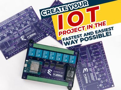

This is the Evtech IOT Universal Controller. This project can control up to seven electronic devices and features eight input pins to connect sensors. You can control your electronic devices using your mobile phone or your PC. I also added a feature that allows me to integrate an i2c LCD with it.

Let's start with the things that you will need. You'll need 14 pcs of 1 k ohm 0805 SMD resistor, 7 pieces of 5 volt relay, a Hi-Link 5 volt power supply, 16 pieces of terminal block, an ESP 32, 1 pc of ULN 2003A IC, and 2 pcs. Of A247 IC, 7 pieces of 0805 SMD diode, 7 pieces of 0805 SMD LED, the case of the project, the PCB stencil, and lastly, the PCB.

Step 1: Soldering Time!
We'll start by putting the stencil on top of the PCB; after that, we are going to apply a decent amount of solder paste and spread it to the place with a hole in the stencil. After doing that, it's time to remove the stencil on top of the PCB. As you can see, using the PCB stencil helps us place solder paste on a PCB board for surface mount component placement more accurately, so make sure when you order your PCB from PCBWay, make sure to get a stencil, especially when you are working with SMD components.
Next to that, it's time to put all the SMD components in place, starting with the A247 IC, followed by the SMD diode, LED, and resistor. Look at that! It really looks awesome! Now, using a hot air rework station, the solder paste melts and effectively sucks the component into the right position.
After that, it's time to solder all the THT components, starting with the ULN 2003A IC, followed by the Hi-Link 5 volt power supply, the 5 volt relay, the female header pins for the ESP32, the male pin for the ESP32, and lastly the terminal blocks.
And we're finally done with the hardware part! Let's go to the Blynk website!
