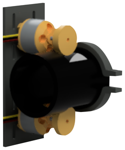

Step 3: The Shooting Mechanism
The mechanism through the balls simply consists of 2 pulleys attached to 2 motors when the ball move inside them they will push it forward and based on the speed of both of them we can control the speed and spin of the ball.
I used 2 brushless motors 1000kv (XXD A2212) and 2 30A ESCs to control, all wiring details and codes in the steps below. I used a 1.5-inch PVC pipe and I made 2 holes in the upper and lower half of it to fit the 2 pulleys.
For the motor fixation, I 3d printed it and you can find the STL part attached.

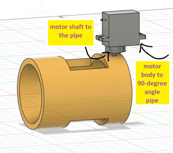

And to move this part to hit different sides of the table I attached a servo motor to the upper PVC 90-degree pipe angle and its shaft to the shooting part

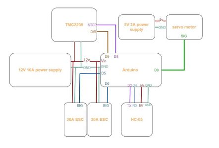

Step 4: The Electronics
I reused another old box to be the container for the electronics which are :
  • power supply 12v 10A to supply the whole system.
  • Arduino Uno, to control all the motors.
  • Bluetooth module HC-05 to communicate with the robot and adjust its configuration.
  • 2 ESCs to control the brushless motor as I mentioned above
  • TMC2208 motor driver for the steeper motor
  • 5v power supply to supply the servo.
Step 5: The Wiring
For wiring, you can follow the diagram.

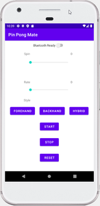

Step 7: Mobile Application
Unfortunately, the mobile application is only for android now and you can download it from here.
