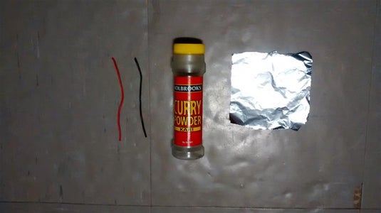

To make this battery you will need the following:
Parts:
  • a good plastic container with a wide lid (mine is a curry powder container)
  • two insulated electrical wires about 10cm long
  • an aluminium foil 5cm long x 5cm wide
  • plasticine
Tools:
  • something to strip off the insulation of the wires(i used pliers)
  • something to make a hole on the lid of your container (i used a hammer and a nail)
  • a multimeter to check the voltage (optional)

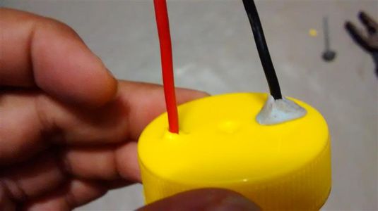

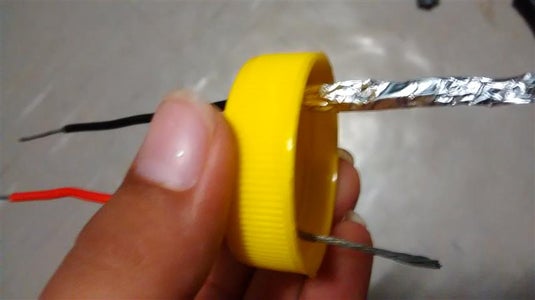

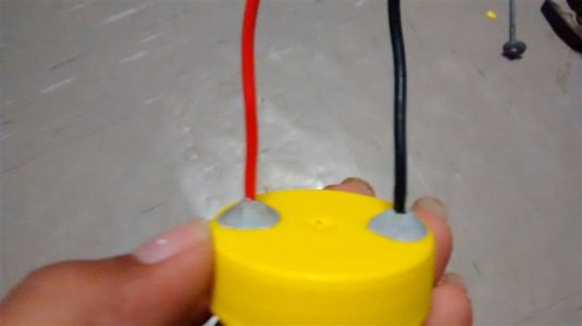

After you have all the materials and tools, prepare your wires by stripping off about 2cm of the insulation on both ends.
After you've done that, make two small holes, a little bigger than the diameter of your wire, on the lid of your containers about 2cm or more apart (make sure they are not too close because this battery doesn't have a separator).
Next, wrap one end of one of the wires with the aluminium foil. That will be your negative terminal.
Put each wires in each holes, leaving about 2cm of the wires on the inside of the lid (make sure the aluminium foil-wrapped end of one of the wires is on the inside of the lid)
Put plasticine around the wires and on the lid so that it doesn't leak. (you can also use hot glue gun. i think it would be better)

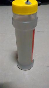

Make some salt water solution by pouring a lot of salt in water inside a cup or something else and stirring it until all the salt dissolves. Pour it into your container, close the lid and you are FINISH!

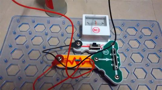

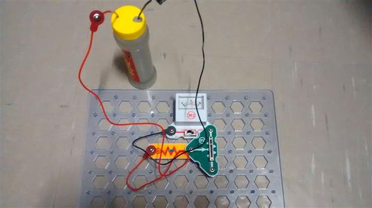

Check your homemade battery with your multimeter and see how many volts you get.
If you experiment with different types of metals as your electrodes and different types of electrolyte you will get different results.
