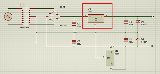

Step 1: Construction of Power Supply Layer
The schematics of the power supply layer is shown in the figure.

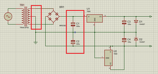

Step 5: Connecting the 330uf Capacitors
The shorter leg of the electrolytic capacitors indicates the negative terminal. Additionally, a negative (-) symbol is marked on the side of the capacitor to denote the negative polarity.
Remember that the transformer has three outputs, with the center tap used as ground. The other two outputs will be used as +12V and -12V.
The electrolytic capacitor between +12V and ground should have its negative (-) leg connected to ground and the positive (+) leg connected to +12V.
Similarly, the capacitor between -12V and ground should have its negative (-) leg connected to -12V and the positive (+) leg connected to ground.
Carefully solder the transformer's center tap and the 330uF electrolytic capacitors onto the board, following the layout shown in the schematic. Ensure all connections are secure and properly aligned to avoid any electrical issues.

Step 7: Connecting 7809 Positive Voltage Regulator
The 7809 voltage regulator features three pinouts. The first pin (Vin) is for the input voltage, the second pin is Ground, and the third pin (Vout) provides a stable 9V regulated output.
To ensure proper operation, connect the input voltage (typically +12V) to the Vin pin, following the placement of an electrolytic capacitor to filter any input noise. The second pin should be connected to the ground, serving as the common reference for both input and output voltages

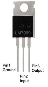

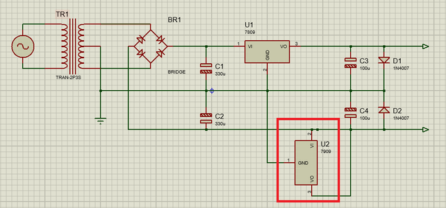

Step 8: Connecting 7909 Negative Voltage Regulator
The pin configuration of the 7909 negative voltage regulator differs from that of the 7809 positive voltage regulator.
The first pin is Ground, the second pin (Vin) is for the input voltage, and the third pin (Vout) provides a stable -9V regulated output.
Zhe first pin should be connected to ground.
Connect the input voltage (typically -12V) to the Vin pin.

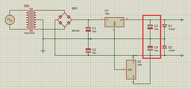

Step 9: Connecting 100 UF Electrolitic Capacitor
Remember that the shorter leg of electrolytic capacitors indicates the negative terminal. Additionally, a negative (-) symbol is marked on the side of the capacitor to denote its negative polarity.
The electrolytic capacitor connected between the 7809 output (third pin, +9V) and ground should have its negative (-) leg connected to ground and the positive (+) leg connected to the +9V output.
The capacitor between the 7909 output (third pin, -9V) and ground should have its negative (-) leg connected to the -9V output and the positive (+) leg connected to ground.
Carefully solder the output pins of the 7809 and 7909 regulators, along with the 100µF electrolytic capacitors, onto the board, following the layout shown in the schematic. Ensure that all connections are secure and properly aligned to avoid any electrical issues
Step 10: Why We Use Capacitors at the Output of Regulators ?
Function of Capacitors at the Output of Regulators
Output Stabilization: Capacitors at the regulator outputs minimize fluctuations in voltage, ensuring a stable output, especially during sudden load changes.
Temporary Energy Storage: They store energy temporarily to quickly respond to changes in load, such as when a circuit component activates.
Improved Frequency Response: These capacitors enhance the regulator's ability to handle high-frequency signals, allowing for effective operation across a wider frequency range.
Noise Filtration: They reduce high-frequency noise in the output, providing a cleaner voltage and ensuring stable operation of connected components

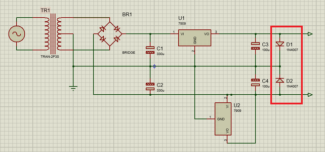

Step 12: Connecting Output Diodes
Diode Orientation:
When connecting diodes at the output, ensure that they are oriented correctly.
The cathode side of the diode is marked with a line.
The anode (positive side) of the diode is unmarked.
Connection Points:
For the +9 V output, connect the anode of the diode to the +9 V terminal.
For the -9 V output, connect the anode of the diode to the -9 V terminal.
Step 13: Why We Place a Diode Between +9 V and -9 V After the Regulator ?
Function of Diodes Between +9 V and -9 V After the Regulators
Prevention of Voltage Drop:
The diode prevents reverse current flow between +9 V and -9 V, thereby avoiding unwanted voltage drops in the circuit. This enhances the safety and proper functioning of the regulators.

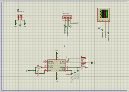

Step 15: ICL 8038 Function Generator Layer
The schematics of the ICL8038 layer is shown in the figure.

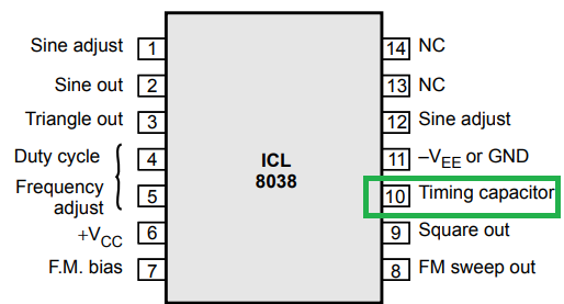

Step 19: Timing Capacitor
Pin 10 : Timing capacitor
This pin is where an external timing capacitor (C) is connected to the ICL8038. The value of this capacitor plays a crucial role in determining the frequency of the generated waveforms. By adjusting the capacitance, the timing of the internal oscillator changes, which directly affects the frequency of the output signals.
I prefered 1uF timing capacitor.
The capacitor, in combination with external resistors, helps set the operating frequency range for the function generator.

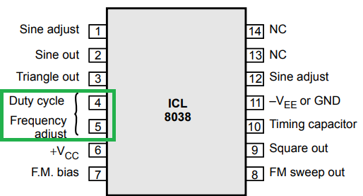

Step 20: Duty Cycle/Frequency Adjust
Pins 4 and 5: Duty Cycle/Frequency Adjustment
The frequency of the output waveform generated by the ICL8038 is directly proportional to the charging and discharging currents of the timing capacitor. To achieve the desired duty cycle, external resistors RA and RB can be selected appropriately. These resistors are connected to pins 4 and 5, respectively, allowing for precise control over both the frequency and duty cycle of the output signal. By adjusting the values of RA and RB, users can finely tune the waveform characteristics to meet specific application requirements.
I prefered 100 K resistors

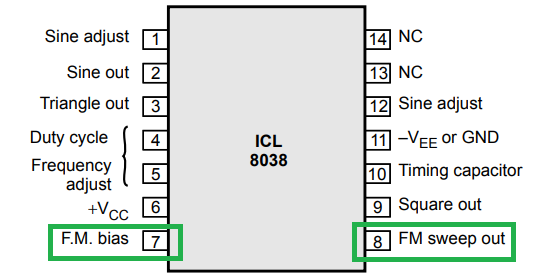

Step 21: Frequency Modulation Bias and Frequency Modulation Sweep Input
In this article I do not focus on function of these pins in details. I give a brief description.
FM Bias: Sets the baseline frequency using a fixed voltage.
FM Sweep Input: Changes the frequency dynamically with an external voltage.
These terms describe how you can set and adjust the output frequency in an FM system, either by fixing it (FM Bias) or by varying it (FM Sweep Input).
Just connect pin 7 (FM Bias) to Pin 8 (FM Sweep Input)

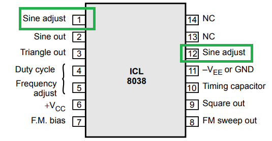

Step 22: Sine Adjust
Sine adjust pins are used to produce more accurate sine wave.
To keep the sine wave distortion below 1%, you need to connect a 100 kΩ resistor between Pin 12 (sine wave output) and ground (or the negative voltage, -VEE). I prefered this one.
Note: To achieve even better accuracy and reduce distortion to less than 0.5%, you need two 100 kΩ potentiometer.
The first potentiometer is connected between VCC (positive supply) and ground, and its middle pin (wiper) is connected to Pin 1. The second potentiometer is connected the same way, but its wiper goes to Pin 12. This setup improves the sine wave quality even further, reducing distortion to below 0.5%.

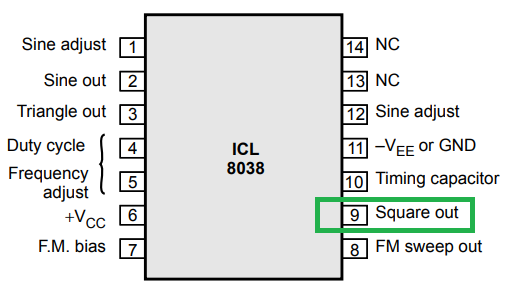

Step 23: Square Wave Output
Pin 9: Square Wave Output
Pin 9 is where the square wave signal is output.
This pin is an open collector output, meaning it needs an external resistor to produce a signal.
To get the square wave, you need to connect a resistor between VCC (positive supply) and Pin 9.

Step 26: ICL 8038 Layer Final View
When mounted on a pertinax board and the components and wires are soldered, the final state of the 8038 layer should look like the images
