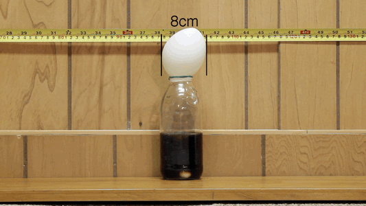

  6. Measure 100 mL of soda in the beaker (Figure 3.2)
  7. Slowly pour the 100 mL of soda into the bottle and mark the height of the liquid (Figure 3.3/Figure 3.4)
  8. Skip step 9
  9. Pour soda into the bottle up to the line representing 100 mL

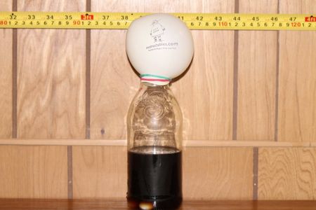

  10. Place a mento into the balloon
  11. Optionally begin recording a video to figure out rate
  12. Wrap the balloon around the top of the bottle
  13. Use two rubber bands to secure the balloon to the top of the bottle
  14. Rustle the balloon so the mentos fall into the soda
  15. Wait 20 seconds or until the balloon has stopped inflating, whichever comes first
  16. Record the width of the balloon
  17. Optionally end recording
  18. Dispose of the 100 mL of soda and wash the bottle
  19. Repeat steps 9-18 three times for the different trials
  20. Replace the rubber bands and balloon with new ones
  21. Repeat steps 9-20 with 2 and 3 mentos instead of 1

Step 4: Data
The Effect of the Number of Mentos on the Amount of CO2 Produced
Trial 1Trial 2Trial 3Average
1 Mento8.0cm6.0cm5.5cm6.5cm*
2 Mentos7.5cm9.0cm9.5cm8.7cm*
3 Mentos9.5cm8.0cm9.5cm9.0cm*
*Note: Averages are in tenths because the data collected is only accurate up to one decimal point
Figure 4.1: Data of biggest width per trial
Figure 4.2: Average of all the trials to show the difference in rate
Figure 4.3: Data table for figuring out rate
Video: All of the trials at the same time
Next two pictures/GIFs: examples from the experiment
Step 5: Conclusion/Validity
It was hypothesized that if a certain amount of Mentos are dropped into a container of soda, then the container with the most Mentos dropped into it will produce the most CO2 at the fastest rate. This hypothesis was supported because 3 Mentos inflated the balloon an average of 9 cm at a rate of .212 cm/sec. This can be compared to 2 Mentos, which only inflated the balloon an average of 8.7 cm at a rate of .202 cm/sec, or 1 Mento, with the balloon inflating an average of 6.5 cm at a rate of .111 cm/sec. It was observed that the difference in rate and width of the balloon was drastically larger between 2 and 3 Mentos than 1 and 2 (as shown in Figure 4.2). This suggests that the amount of dissolved CO2 in the soda is close to being completely used up.

Reliability: The data is reliable because it is supported by other experiments, the constants were kept, and the procedure was followed closely. A human error in this experiment that lowered the reliability was that the balloon did not make an airtight seal with the bottle (see trial 3 with 1 Mento in the video). This can be solved by using a tighter rubber band or by using two rubber bands (see trial 3 of 3 Mentos). Two additional constant variables that should have been kept are the time waited before recording the data, and the type of balloon used. These would both increase the reliability of the data by raising the precision of the data.
