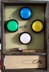

This cache is composed of 4 buttons - Blue, Green, White and Yellow. Nothing special about the colors - just the button colors I had at home in that moment. You can use the ones that take your fancy.
We have 5 levels (you can set that in the code) that we need to overcome. In each level is necessary to press a number of buttons (again, you choose that in the code) that will increase with each level.
The buttons that are needed to be pressed are shown before each level starts. By advancing the level, the time between each button turning on and off gets shorter, meaning you have less time to memorize the sequence.
Don't bother to memorize the sequence between failures - each time a new game starts, it's a new sequence. :)
The speaker plays tones with each button. That can also help. The tones are always the same for each button. When showing the sequence to repeat, you'll ear a tone. Play the video to show the game.
If you get all the sequences right, a music is played and the servo releases the gate latch that opens the door for the logbook.

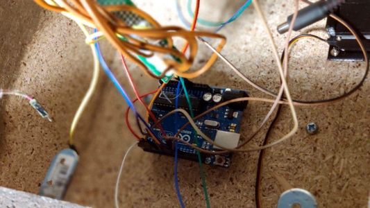

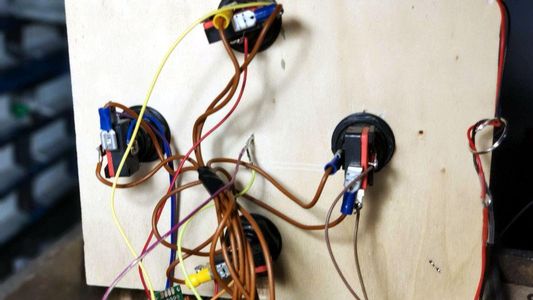

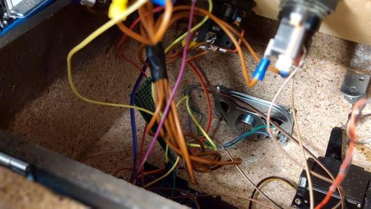

Step 3: Electronics
The wiring for this cache is simple.
The follow the schematics to know where to wire each button and each button LED, as well the middle LED (this one signals when to start entering the sequence), the buzzer and the servo.
The Arduino will be powered from the jack connector, from the 9v battery connector. This will power the entire cache.

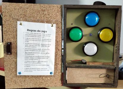

Step 4: Container
For the container, like all my other caches, use wood to create a big rectangle.
I've separated the electronics compartment above, and a small compartment, with a door, bellow for the logbook.
This compartment is held locked by the gate latch, that opens when the game is won.
I've attached the 3D printed files for:
  • Securing the servo motor to the wood
  • Pin on the door that locks in the gate latch.
