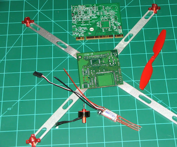

Step 2: Build Step - Electronic Speed Controller
Image 1: Electronic speed controller shown in its shipped state.
Image 2: Brushless motor also shown in its shipped state.
Image 3: Shows my soldering modification to directly connect the motor to the esc. This is not a beginner soldering mod, but if you have a proper hot iron, patience, and determination you can do this as well. I made this mod to clean up the wires and remove some weight.
Image 4: Shows a totally different esc. I am just demonstrating that I removed the signal wires and replaced with connectors for the brushless motors. *again - wire management* - you will discover weight determines battery times.
Last image: Sometimes these motors ship without ends, so this shows how I also modified the brushless motor wires with connectors (shrink wrap is your friend).
