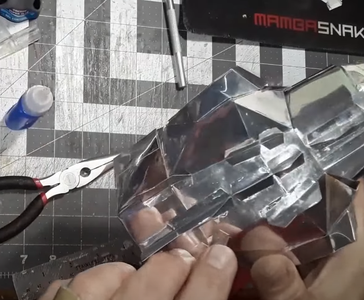

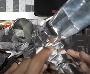

Step 1: Head Construction
Using the templates provided, we start building Mechagodzilla's head and neck. We use different color can to make the eyes, the head details and the nose pieces. We then move on to the neck assembly and add the head and neck spines.

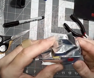

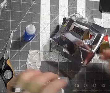

Step 2: Neck & Torso Construction
Using the templates provided, we move on to Mechagodzilla's main neck and torso structure. We start by constructing the shoulders and work our way down to the chest. We make sure to add the neck and torso spines along the rear axis of the model.

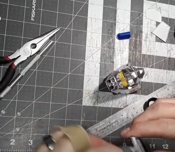

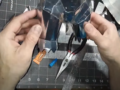

Step 3: Waist & Leg Construction
Using the templates provided, we begin at the waist and work our way down each leg, carefully assembling each piece until we reach the ankle section of each leg. Once there, we start work on each foot, which consists of 6 pieces. We glue these together to form one foot then repeat to make the second foot. We then glue each foot to the ankle joint with some craft foam glued in between so the pieces adhere well.

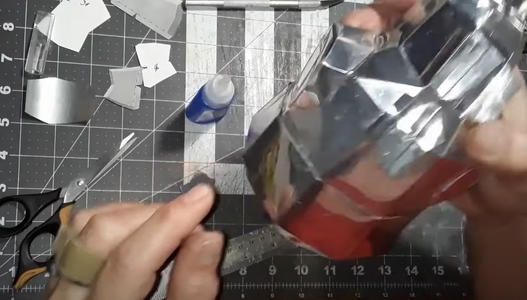

Step 5: Torso & Leg Assembly
At this point, we are ready to join the upper torso/head assembly with the waist and leg/foot assemblies. We use Hot glue to join both sections as shown.

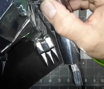

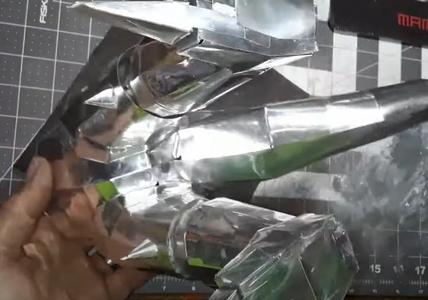

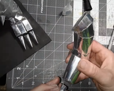

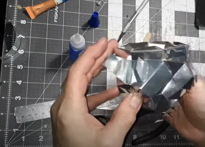

Step 6: Arm & Hand Assembly
Each of the arms is started next by assembling and gluing each piece in order until we reach the hand. We then assemble the hand and then glue on each of the fingers. We repeat the above steps to complete the second arm and hand. Finally we glue each arm into position on our soda can model, completing Soda can Mechagodzilla!
