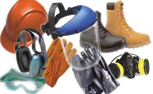

Step 1: Step 1: Safety First!
You are going to potentially be working with extremely high temperatures and molten metals, so make sure to use the appropriate PPE. That includes eye protection, a face shield, leather apron, heavy pants, leather boots, and welding gloves at a minimum. That said, when we're talking about molten metal spitting around at 1000 plus degree in temp. your PPE can only do so much, so the best protection is to be very careful and not let molten metal go spitting around your shop in the first place!
Here is a link to considerations of PPE from a professional foundry organization.
https://www.moderncasting.com/articles/2017/11/01/considerations-ppe-melting-pouring-foundries

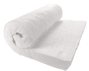

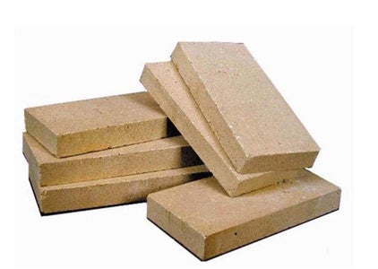

I started by putting fire brick on the bottom of the bucket and lining the sides with ceramic fiber blanket (also called kaowool). I put an interior cardboard cylindrical mold used for concrete to make the inner portion of my mold and then packed castable refractory between the kaowool and the cardboard mold.

The lid of the Furnace should also contain the ceramic fiber ( kaowool), and also castable refractory. I added a mesh of steel to act as a rebar grid. Let the lid and bucket refractory cure overnight.
