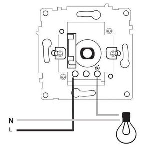

Step 6: Electricity
I needed to provide my bookshelf with the light that would allow me to work in the desk area and at the same time have a warm light in the living room when needed, so I installed a dimmer and some variable led bulbs, the lamp holders are metal caps with porcelain coating, I found them in an antique shop and they date back to about 1920.
