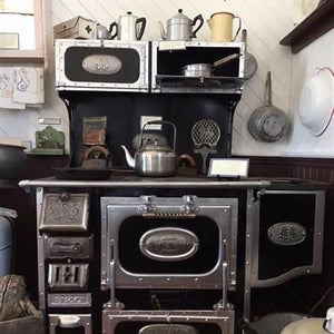

  2. Then, I looked up photos of early 1900s farmhouse kitchens and collected references of old stoves, wallpaper patterns, furniture, and shelves. I kept asking myself, “What would Mrs. Wright’s world look like, and how would it feel?” That’s when the emotional part of the design clicked for me.

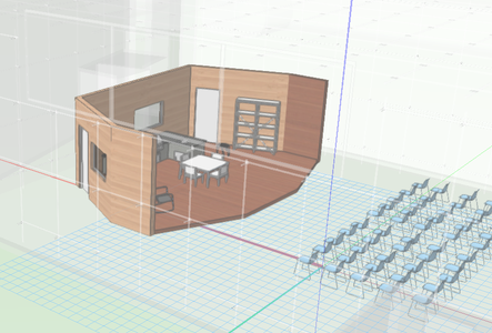

  1. After gathering references, I drew a rough layout of the stage. I figured out where to place the stove, kitchen table, windows, and the doorway to the upstairs. Since this was a class project, I also recreated the space in Autodesk to plan things out to scale and get accurate proportions
  2. This digital sketch helped me understand how much space I’d need and made it easier to build later, even a clear sketch with a ruler works, as long as it’s scaled.

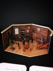

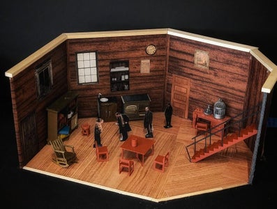

  1. For the base, I cut a piece of foam board to about 12x18 inches to match the scale I picked. I then cut out walls from foam board and attached them with hot glue, keeping the corners square. I left space for windows and the upstairs door.
  2. I made sure the walls were around 5 inches tall to keep it proportional. If you’re doing this, be gentle with the foam board, it dents easily, but it’s perfect for this kind of model. I also added wood strips inside the corners to help the walls stand strong.
Step 4: Adding Furniture and Props
  1. This was my favorite part. I made a kitchen table and chairs from scrap foam and sticks. For the stove, I used a mix of cardboard and some 3D-printed parts. I added shelves, boxes, jars (using beads), and even a quilt made from cut-up fabric scraps.
  2. Don’t worry if everything isn’t perfect. I focused on what felt right emotionally. The birdcage, for example, had a broken wire door, a big clue in the play. These small props made the story come alive.
  3. If you’re building your own version, keep the furniture simple but symbolic. Use any materials you have around, the story matters more than realism.
Step 5: Printing and Attaching Textures
  1. To make it look more realistic, I printed out old wallpaper patterns and wood flooring textures I found online. I cut them to size and glued them to the inside walls and floor using Mod Podge.
  2. I also made curtains with tissue paper and printed little picture frames to hang. These finishing touches really helped sell the idea that someone lived here. If you’re doing this step, print textures on regular paper and take your time cutting clean edges.
Step 6: Figures and Emotional Touches
  1. I printed and cut tiny paper figures to represent Mrs. Hale, Mrs. Peters, and the Sheriff. I placed them around the kitchen to match scenes from the play. I also made sure emotional props like the broken birdcage and sewing basket were placed in focus.
  2. You can also add character tags or quotes to certain props, I didn’t in mine, but it’s a great idea if you’re presenting the model. The goal is to create a feeling of quiet tension, not clutter.
