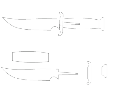

Step 1: Pattern
Print the pattern using fill picture to frame option.
