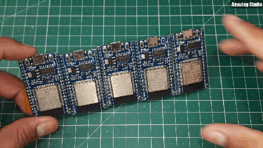

Few days ago, I designed a ESP32 based microcontroller development board. I revealed the Gerber files and SMT process in the previous written “Order with JLCPCB SMT assembly service”. I tested the board with different programs and Wi-fi sharing. And now I am here to show the schematics, circuit assembly and give a full review of this DIY board. Actually, not fully DIY, most of the work is done by JLCPCB SMT assembly service starting from $8.

Step 7: PCB Designs:
If you want to use designs then here is the downloading link, all the 3 files Gerber, BOM and CPL is shared. So, you can try SMT service form JLCPCB.
Here I am using blue color, HASL finish, 1.6mm doubled layered PCB. I adjusted the components to match the parameters with original ESP32 boards available in market.

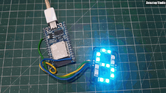

Step 8: Working:
I tested this ESP32 module with 7 segment display, I got the files of 7 segment display from a friend on Instructables. This program is to display numbers on the LCD.
Also, I noticed that there is an issue with my designs, when upload the sketch programmer will not shift into programming mode automatically. So, we have to give an external trigger by pressing BOOT and FLASH button. I think transistors are not working properly. Well, I will update the schematics again and then try again with new designs. Here is small video of upload sketch to esp32.
Step 9: Troubleshooting:
1) If you are not using SMT service then make solder joints correctly.
2) Don’t heat the Wi-Fi module too much, when soldering.
3) If microcontroller doesn’t switch to programming mode then reboot and flash the controller using tactile buttons.
