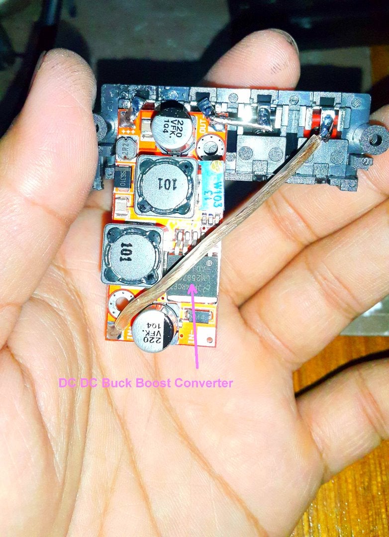

Step 1: Getting a Stable Power Supply.
All three components of the DRU use 12VDC. The car 12V accessories circuit does not give a stable power output for sensitive electronics. I used a DC DC buck boost converter to give a guaranteed 12.0VDC out for the DRU. I used a spare speaker wire quick connector to allow easy use during implantation.

Step 4: Installing the Power Supply.
Behind the glove box I cable tied the DC DC converter. There are no metal parts nearby to allow for an electrical fault and in this area it is very cool thanks to the air conditioning evaporator.
