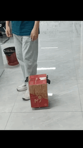

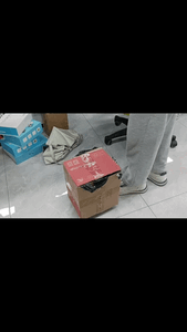

Step 4: Test It Out!
Now that we've put our "Automated Following Trash Can" on the ground and turned on the switch, it's time to enjoy the fun of having our own "little follower"! But during testing, I found that if I walk too fast, it can't keep up with me. And if I make sudden turns to the left or right, it sometimes struggles to react in time. If any of you have any better ideas to improve its performance, please share your thoughts in the comments section! Let's brainstorm together and make this "little follower" even better!
