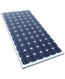

An air conditioning unit uses lots of energy to remove heat from a room. To provide that energy you need enough solar panels installed properly to capture the radiant energy of the sun. When it comes to solar power - "the bigger, the better!".

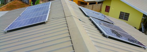

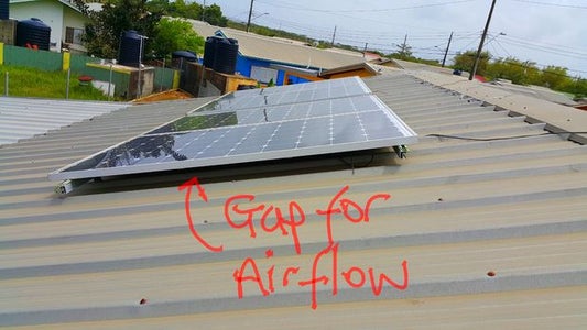

I currently have eight 225watt panels on my roof, wired 4 in series and in parallel with the other string of 4. These give me the energy to power my lights, automation pc, refrigerator, dog feeder, WiFi, small appliances and of course that wonderful air conditioning unit.
Mounting can be with a roof rail kit or you can do your own custom mounts made with metal and/or rigid pvc.

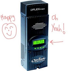

For 1 kilowatt and higher you want a maximum power point tracking (MPPT) charge controller. Basically it gives higher efficiency, can accept a higher voltage to deliver the amps into the battery bank.
I use the outback flexmax 80amp mppt controller. It's the best in class for the industry and it's worth every cent of its cost. It's fully programmable and can handle up to a 60 volt Dc battery bank.
Notice the happy face I drew? Not even the evil scientist guy in despicable me would be as happy making his evil plans.

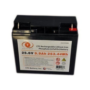

My battery of choice is the LifePO4 chemistry. Long life, zero toxicity, enviromentally friendly, high energy density and best of all completely safe (won't blow up! Lol).
My system is 25.6v and uses 16 batteries in parallel.
I previously used lead acid batteries but they simply didn't last long. In 14 months their capacity was approximately 40% of their original. This was a costly mistake and I gave away these and made my LifePO4 bank. They have been performing admirably and even though at higher upfront cost, the higher service life is well worth it. Please read my instructable for this bank.
https://www.instructables.com/id/Lifepo4-solar-sto...
Now for anyone doubting the capabilities of LifePO4 batteries, there are many good sources on the web detailing this chemistry. Also think about this: why dont your mobile devices use lead acid batteries? Hmm. Lithium is superior plus I even have a LifePO4 battery to start my car! Take a look.

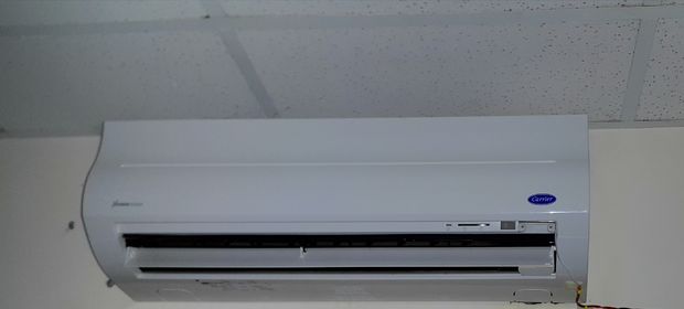

The only option for solar powered air conditioning is to use an inverter air conditioning unit. This is the most energy efficient type in the industry and it is simply amazing. I actually gave away my original 18000btu unit to install a 10000btu inverter.
My inverter AC unit can use as little as 240Watts right up to its maximum rating. This unit runs off 240 volt so I needed a means to power it.

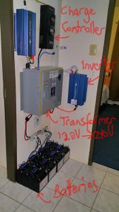

Step 5: Going From 25.6v Dc to 240v AC!

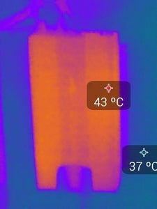

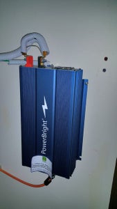

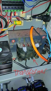

How to make this happen? Easy! I used a 1000watt inverter accepting 25.6v dc and outputting pure sine wave AC at 120v. Next I used a 1500watt autotransformer to boost the 120v to 240v. I included a thermal image of the transformer under load. Autotransformers have higher efficiency at the expense of no galvanic isolation once the voltage ratio is 3:1 or less. I could not obtain a 240volt inverter at a reasonable price at the time of the installation, perhaps in the future I will get rid of that, urgh, transformer.

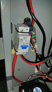

Protection for my battery bank is provided by a mini circuit breaker 100amp.
Since my pure sine wave inverter can only deliver 1000Watts, the lowest temperature I can get to on battery power is 26C which is pretty good. If you can afford a bigger unit then all the more power to you!

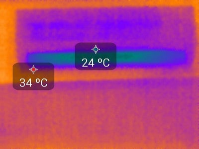

With the inverter on and the air conditioning unit powered, I enjoy comfortable air from my battery bank. I included a thermal image of the unit running off the batteries.

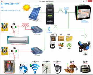

Please note that with my setup I don't have a large enough battery bank to run the unit all night. Therefore I implemented an automatic transfer switch to power the unit from our utility when a low voltage dc threshold is reached.
The transfer switch is fully software controlled by my home automation pc. Take a look at the third and forth pics. The software was created from FLOWSTONE. Take a look at my home automation instructable. https://www.instructables.com/id/Creating-a-home-a...
