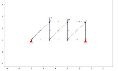

Step 1: Start Building Model by Adding Truss Elements or Members
For us to start building the model, we need to install the anaStruct library.
pip install anastruct
Then we build our Truss model by instantiating the structure object. This is implemented by importing systemElements class from the anastruct library and instantiating it.
Then we can access all the structure objects states, including elements, materials and forces.
#lets import the systemElemnts from the anastruct libraryfrom anastruct import SystemElements#instatiate the SystemElement objectss = SystemElements()#lets add truss members at node using add_truss_element method and passing coordinate loaction as argument to #define length of each memberss.add_truss_element(location=[[0, 0], [3, 0]])ss.add_truss_element(location=[[0, 0], [3, 3]])ss.add_truss_element(location=[[3, 3], [3, 0]]) ss.add_truss_element(location=[[3, 0], [6, 3]])ss.add_truss_element(location=[[3, 0], [6, 0]])ss.add_truss_element(location=[[3, 3], [6, 3]])ss.add_truss_element(location=[[6, 3], [6, 0]])ss.add_truss_element(location=[[6, 3], [9, 3]])ss.add_truss_element(location=[[6, 0], [9, 3]])ss.add_truss_element(location=[[6, 0], [9, 0]])ss.add_truss_element(location=[[9, 0], [9, 3]])#this method plot our assemble structuress.show_structure()

Step 3: Add External Load to Nodes of the Model
okay lets add some point and horizontal loads to our model
# Add loadings#the point_load method indicate it is a point load #the argument fy indicate it is a vertical force and negative sign indicate downard acting at node 4ss.point_load(Fy=-6, node_id=3) #acting at node 4ss.point_load(Fy=-4, node_id=4)#Fx is a horizontal force acting in the positive direction at node 6ss.point_load(Fx=+10, node_id=6)

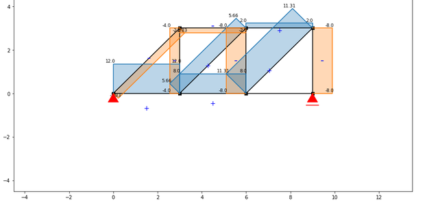

Step 4: Compute and Plot the Axial Forces in Members Due to External Load
lets calcuate our axial forces in the members due to external load and plot the result
#this method compute all the reaction forces and axial forces in the modelss.solve()#this method plot the computed axial forces of the truss elements or members  ss.show_axial_force()

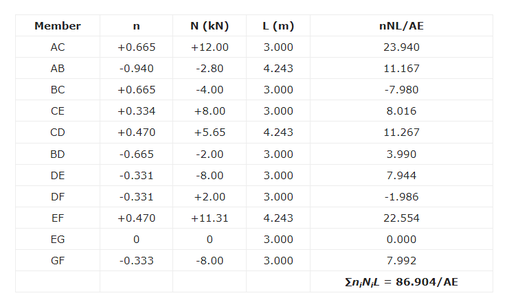

Step 10: Compare Your Table and Compute Deflection
The first table above is the author's solution from the structville website and the second table is my program computed table
Let's finally compute our deflection and compare it with one from the example
#we compute deflection at node 2deflection = df1["nNL/AE"].sum()print("The vertical deflection at node 2 is :",deflection.round(3),"/AE meters")#output from the program87.255/AE meters#result from the example in the article86.904/AE meters
