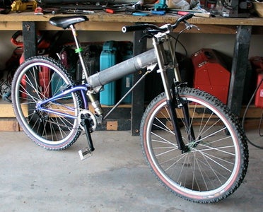

I had previously sold my mountain bike and I really missed it so I decided to put together a new bike using parts I had in my garage. I built a frame around ten years ago when URT's (unified rear triangle) were somewhat popular and it actually rode pretty well so I thought I'd use a tension link (pull rod) design for a fun single speed. It may look flexy but it's really pretty stiff in torsion- the boom tube is made from .049 wall 4130 and the pivot is pretty beefy as well. The pivot sits directly over the BB so the suspension is always working, even when you stand, unlike the old URT designs. The steel frame here is probably close to seven pounds and it could be built a fair bit lighter.
This design can be constructed from Aluminum for a much greater weight savings and it can also be built to have as much as six inches of travel with a longer stroke shock.
The drawing shows a four inch travel version- note the difference in the rear triangle construction. Each square on the drawing equals one inch for scale.

Specs for the prototype are:
4" front travel
3.5" rear travel
15.75" chainstays
12.75" BB height
69 head angle
73 seat angle
23" top tube

Step 2: Modifying the Rear Triangle
Originally the rear end was used on one of the old Scwinn Buell bikes- they rode pretty awful. I modified it by welding on a bottom bracket shell and additional plates to mount the cranks and get proper chainring clearance. At some point I will weld up a new purpose built rear triangle with slightly longer chainstays that is a bit lighter, but for this "proof of concept" bike the Buell rear triangle works pretty well.
Step 3: Making the Front End
The front of the frame was welded up using a section of airfoil shaped .049 in. wall thickness 4130 tubing. This is some pretty beefy tubing! I welded the head tube in first as I knew that would be a tricky miter to get right. Then I welded the pivot from the Schwinn bike to the seat tube and then welded the seat tube assemby to the airfoil section. The seat tube had an additional collar welded into it to hold the seatpost. Next I welded on the mounting tabs for the pull rod and shock. The pull rod is really easy to make- just weld in the threaded ends into the pull rod tube and then thread in the rod ends. It's really important to use high strength rod ends- anything less will self destruct. Since the seat tube is so beefy there wasn't any need for reinforcement. Eventually I will try to make a super light Aluminum front end.
Step 4: Linkage
I made the linkage plates from .125 in thick steel sheet. The bronze pivot bushings came from the old Schwinn bike's linkage. On the next version of this design I'll have the linkage machined from a single piece of Aluminum.
The suspension is a very simple design that works extremely well- as the back wheel absorbs a bump the pull rod pulls on the linkage, causing the shock to compress. I set my suspension up so it sags at about 25% of compression, which is about right for a shorter travel bike like this.
