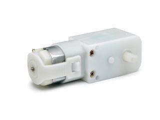

8. 2X BO motors
9. 1X castor wheel
10. 3X Sonar sensors
11. wheels for BO motors

As I have told I wasn't sure what was I going to make. So I started with two Bo motors ,two wheels and some cardboard. You can see my initial base design. later I discarded that and made myself a new one, You can see the details in the pictures..Initially I was going to use the wheels made for 6mm center shaft DC motors as those LOOK GOOD,but somehow the red wheels felt more stable on the BO motors. So I used them.
And oh,I used a Castor Wheel at the base to balance the robot.
