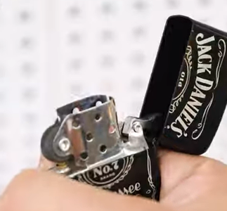

Let’s turn your Zippo into a unique statement piece! Laser marking adds permanent logos and custom designs with precision, enhancing both style and functionality.

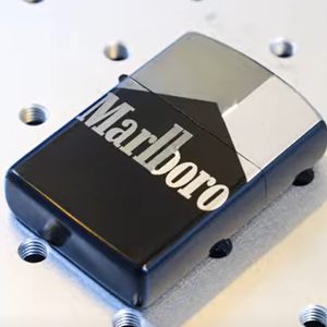

  1. Laser Marking
  2. Speed: 1700mm/s
  3. Marking Power: 20%
  4. Frequency: 20kHz
  5. Line interval: 0.02

Step 6: Complete the Laser Marking
Once laser marking is complete, carefully open the door and get your personalized Zippo. Laser marking does not produce toxic substances, and you can use the Zippo after a simple cleaning!
