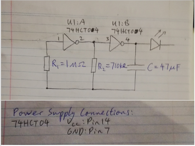

This article provide the circuit diagram and a video demo of:
  1. astable multivibrator (Step 1 - 2)
  2. monostable multivibrator (Step 3 - 4)
Information in the brackets indicate the exact supply that I used. You can use alternatives.
  1. 2X NOT gates (on 1X 74HCT04 IC chip)
  2. 1X OR gate (on 1X 74HCT32 IC chip)
  3. 1X capacitor (47 uF)
  4. 3X resistors (1MΩ, 710kΩ, 100kΩ)
  5. 1X LED
  6. Power supply for the logic gates (I just powered them from an I/O board)
Step 1: Circuit Diagram (astable Multivibrator)
The circuit diagram is the image above.
