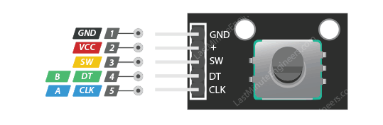

Step 3: Rotary Encoder Pinout
GND is the ground connection.
vcc is the positive supply voltage, usually between 3.3 and 5 volts.
SW is the output of the push button switch (active low). When the knob is pressed, the voltage goes low.
DT (output B) is similar to the CLK output, but lags CLK by 90° phase shift. This output is used to determine the direction of rotation.
CLK (output A) is the main output pulse used to determine the amount of rotation. Each time the knob is turned in either direction with only one detent (click), the "CLK" output goes through a high then low cycle.

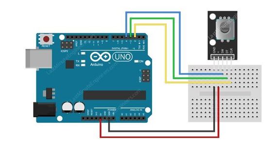

Step 4: Connecting the Rotary Encoder to the Arduino
Now that we understand how the rotary encoder works, it's time to use it!
Let's connect the rotary encoder to the Arduino. The connections are pretty simple. Start by connecting the +V pin of the module to the 5V output of the Arduino and the GND pin to ground.
Now connect the CLK and DT pins to digital pins #2 and #3 respectively. Finally, connect the SW pin to digital pin #4.
The image below shows the wiring.
