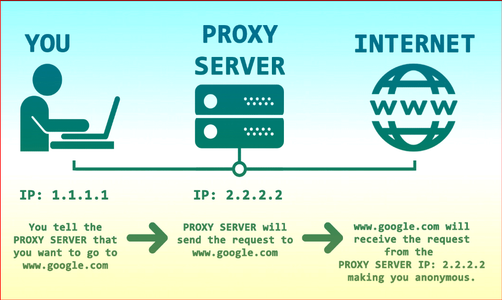

The proxy server is a computer on the internet that accepts incoming requests from the client and forwards those requests to the destination server. It works as a gateway between the end-user and the internet. It has its own IP address. It separates the client system and web server from the global network.
There are a lot of benefits to setting up a proxy server. The website you access will not be able to log your real IP address, as it will log the proxy server’s IP address. You can use it as an ad blocker. The admin of the system can also control the user’s accessibility to specific websites that seem malicious. By doing this, the admin prevents the users to get into any trouble and ensures their security. You will also save yourself from being tracked.

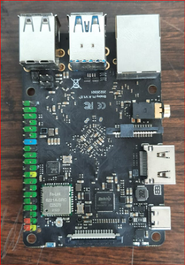

Brainy Pi
Ethernet / Wi-Fi
