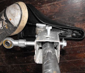

Step 8: My Specifics: Attachment to Bike
My system of attaching the trailer to the bike basically relies on the female rod end to pull the full trailer's load via its attachment to my bike. There are definitely many other ways to do this; I want to adapt this to include redundant attachment between bike and trailer for a future version (ie 2 bolts instead of 1)...
