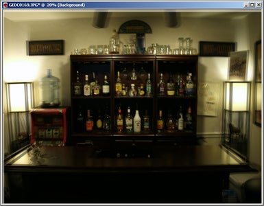

To illustrate this, I decided to take a picture of something in my apartment. Specifically, my bar. I love my bar. Putting the images side-by-side, and making sure that vertically, they're lined up, I can very easily create a 3D free-view image of my bar. (Image 1)
It's important that your cameras are able to take pictures so *everything* is in focus at the same time. The background should be as clear as the foreground. Focus shouldn't be on a specific object in order to get the real 3D effect. For my digital cameras, I had a "party" mode that specifically worked in low-light conditions AND stated that it could "capture the background party."
For your own camera, you make have to experiment with some of the modes, though pretty much every digital camera today has *some* mode that will do this. If you have a scanner, you can even use cheap 35mm cameras if you don't mind waiting for them to print out, and you're okay with living in the stoneage.
So I took my two cameras, got them ready for the photo, held them side-by-side (approximately a foot apart) and snapped the picture at the same time on both. Now, there are lenses out there, and even devices you can build that will snap a single picture with a single camera and give you the split images (involving mirrors, and way too much time) but this is about doing something quick, and easy with stuff you can find in the department store 10 minutes before the wedding.
It IS important that you get your timing down when snapping the two images, as ANY movement that happens between the two images will be very obvious. When using two cameras, I strongly recommend marking your "right" and "left" camera, because filtering through a bunch of images trying to figure out which is which sucks. Trust me.
So let's return to my bar... After having taken the two pictures, I now need to make sure they're correctly aligned. Start by placing your images into a photo editing suite, and putting each on a different layer (keeping track of which is the right, and which is the left). For the photo on the top layer, set its transparency to 50% so you can see how the two line up. (Image 2) Now, pick a spot
somewhere in the middle of the image (in this case, I chose the white Malibu bottle) and line up the two images as closely as possible. (Image 3)
Finally, crop your images so no background shows on either image, then place the right image on the left, and the left image on the right to create an easily free-viewed 3D image! (Image 1)
