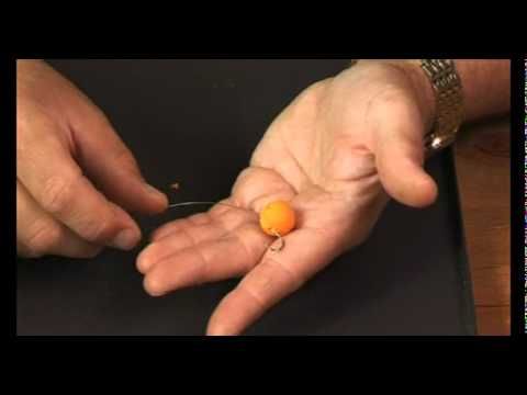

The rig is now complete!
Step 31:
With the dental floss tie on a boile with a slip knot
Step 32:
Tie onto the O ring
Step 33:
Trim off the excess dental floss and the rig is ready to cast out.

Step 42:
Here is a video showing how to tie the Blowback rig with a hair;
http://www.youtube.com/watch?v=DFWVKBvwFb4&feature=player_embedded
Step 43:
Here is a video showing how to tie the Blowback hairless rig;
http://www.youtube.com/watch?v=OIueQVbJPmM&feature=player_embedded
