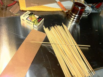

Needful things
- a bunch of bamboo skewers (or straws)
- enough corrugated cardboard to cover your project
- some sort of a marker, like a sharpie
Step 2: Insert Sticks
Next, cut a strip of the corrugated cardboard and stick the bamboo skewers through the grooves/holes/openings of the cardboard.

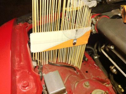

Step 3: Use!
Then, position that funky tool you have fashioned over the compound curve you want to duplicate, and gently push on the skewers until they just touch the surface. Hold the cardboard level.

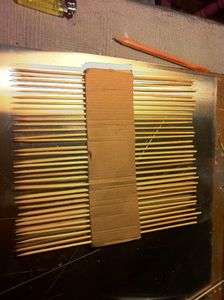

Step 4: Trace
Here's a look at the other side.
Once you have captured the shape of the curve(s), all you need to do is to trace it on another piece of cardboard and test fit.
Then, transfer the shape on the material of your choice and cut away.
