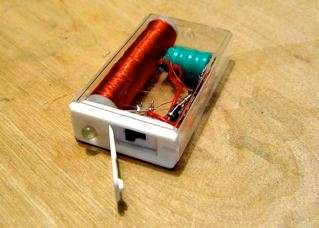

Using electromagnets, a small-scale LED flashlight similar to that featured in "Shake It Like a Tic-Tac!" can be produced.
With the setup for the Tic-Tac flashlight, the voltage produced by the magnet alone may not be enough to power up the LED. It is possible that the only reason the LED lit up was due to the rechargable battery not being completely empty in the first place. This theoretical experiment attempts to improve on the circuit based on one of the comments made on "Shake it like a Tic-Tac!"
Image taken from Shake it like a Tic-Tac! page.

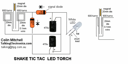

Mr. Mitchell over here (Jan 27, 2009) had a good idea of improving the circuit, and so here's his diagram to help guide you in assembling the circuit.
Basically, the circuit itself is in series, and it follows this diagram:
The coils actually sit flat against the slide (against the side of the magnet) as shown in the diagram below. You must get the end of the magnet to fully pass though the coil so the voltage will be a maximum. Thats why the slide extends past the coils at the top and bottom of the diagram.
You can solder the circuit together and, there you'll have it.

1.6v + 0.6v = 2.2v, and that is the voltage the coil needs to produce.
It is good that there are electrolytics in the circuit, since these will keep the LED illuminated for the time it takes for the magnet to make another pass through the coils.
