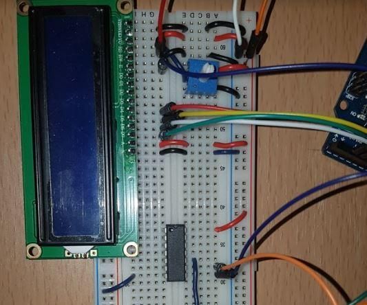

Step 3: Making the Circuit (Power and Ground)
Okay let's get building, shall we?
I have attached a bunch of pictures of the circuit diagram and schematic to help you while you build.
What we want to do first is make sure our Arduino is connected to a power supply so it can turn on. Once that is done, we can start setting up our breadboard. First attach a wire between the GND pin on the Arduino and place it into the horizontal railing on the side. This will be our ground line. Then, attach the 5V pin on the Arduino and place that adjacent to the ground railing. This will be our power line.
Step 4: Making the Circuit (placing Components)
Now let's place the photoresistor, the 1k Ohm resistor, and the relay onto our circuit. Place the photoresistor anywhere on your breadboard, but make sure its two legs are on two separate vertical rails. Then attach a wire from the left leg into the ground railing. Then attach another wire on the right leg, going into the A0 (or analog 0) pin on the Arduino.
On that same railing, attach the 1k Ohm and place the other leg of the resistor anywhere on the breadboard (preferably close by). The leg of the resistor that is not connected to anything, attach it to a power railing by using a wire.
Finally, place the relay between the gap on the breadboard. Make sure pin NO and the coil pin are on the left side and the common pin is on the right side.
Step 5: Making the Circuit (attaching the Lightbulb)
Now let's attach the light bulb to the relay. Connect terminal 1 to the relay with a wire. Attach it to the pin that is on the left hand side of the ground wire (the NO pin). If you are doing this project with actual tools and not on a program, use the lamp holder with the exposed negative terminal and connect that into the relay. Then use the pin that is directly across the relay (coil pin), and attach that to pin 4 on the Arduino. This might be a bit confusing so make sure you see the breadboard diagram and the pin layout.
Step 6: Making the Circuit (attaching the Battery)
Okay, this is the final step in the circuit design. Attach the battery onto the 9v connector and place the ground wire onto the common pin on the relay and the power wire on the cathode terminal of the light bulb.
