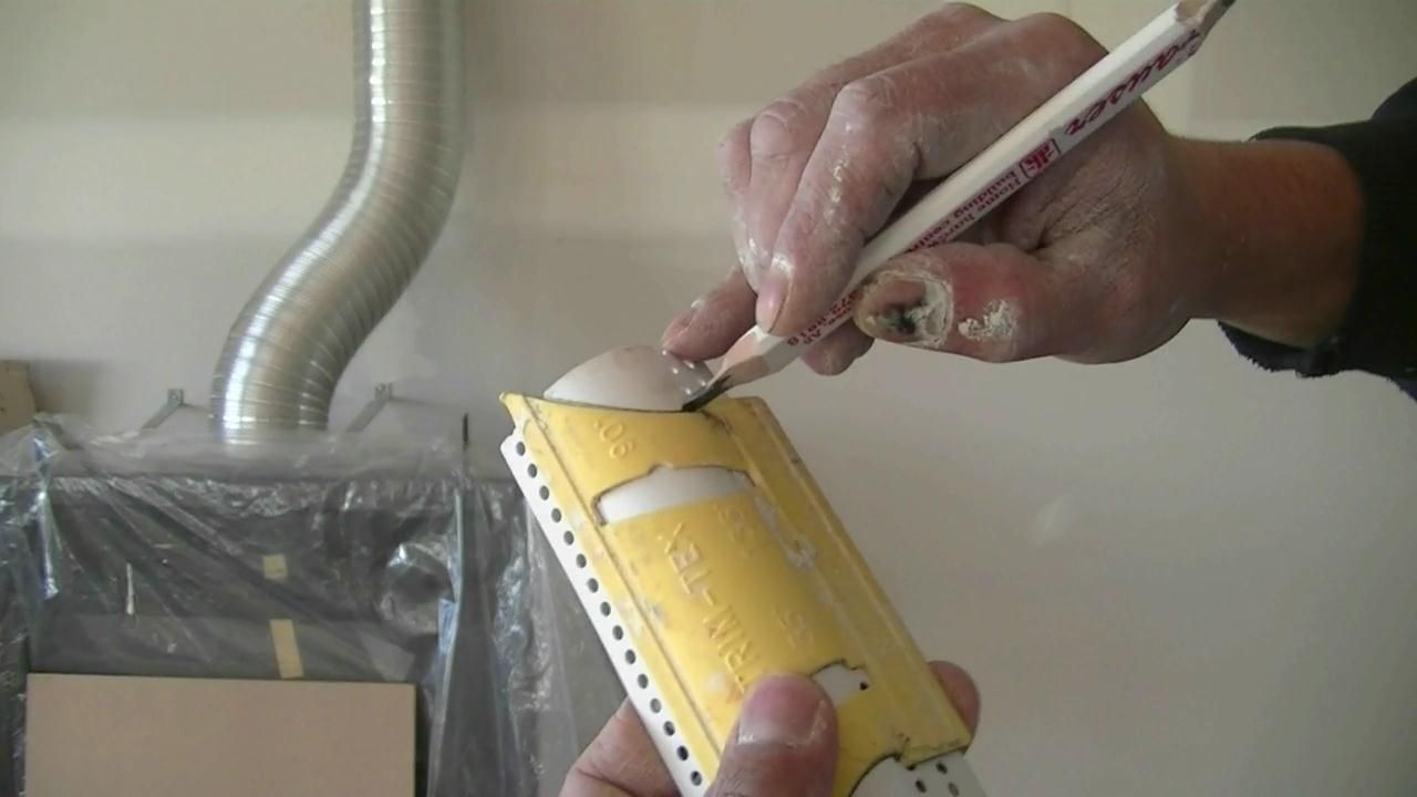

Circular cuts
Circular or radius cuts may be accomplished by using a keyhole or jab saw. You can trace out the radius (or circle) with a compass or perhaps a pencil attach to a rope and thumb tack (significant radius cuts).
Circle cutting device :
The circle cutter is really a compass that employs a “blade” instead of a pencil. This works quite well for circular cut outs. The circle cutter won't cut the hole all the way through, you'll need to end the task which has a utility knife.
