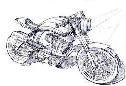

Step 3: Creating Rough Sketches
The first step in designing a motorcycle is sketching ideas and finalizing what you like. This step can be done in pencil, or pen. I would recommend pencil as it is easier to correct is something gets messed up. When starting a pencil sketch I would recommend starting off simple by drawing circles where you would like your wheel placement. This is a big factor with the over all frame design as well as the angle for your front end. After you have the wheels drawn in id recommend you next sketch out the frame and front end. Once you have done this the rest can be done in a random order, just make sure that when drawing the handle bars don’t interfere with the gas tank or become limited in the range they turn.

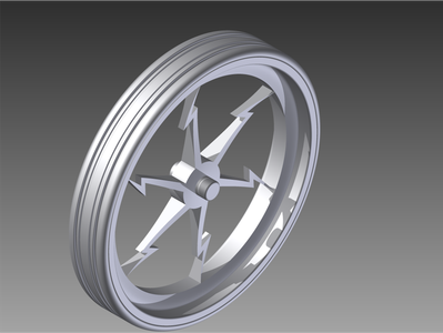

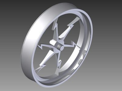

Step 5: Creating Your Rims in Autodesk Inventor
this video will take you through the steps on creating a rim in Autodesk inventor

Step 9: Creating an STL From Autodesk Inventor
This video will show the steps of taking the rim designed from the earlier video, creating an STL for that piece and bringing it to another program. The program is called CatalystEX, this is the software that will be used in printing all the parts of the motorcycle in 3D from the 3D printer.

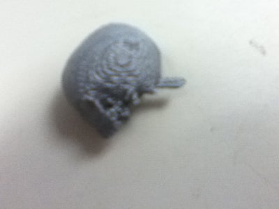

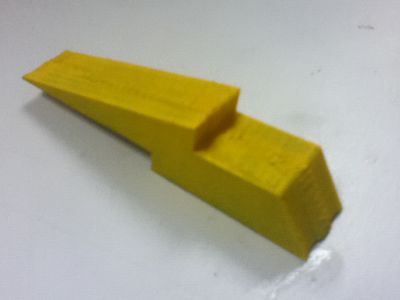

Step 10: Rapid Prototyping the Parts for Assembly
This video will show you how to use the program CatalystEX in order to print out your parts for a scale model.
Step 11: Setting Up a Print on the 3D Printer
In this slide I will show you 4 videos. These consist of starting the print up, the first couple layers of support material getting put down, the last 4 minutes of the part being finished and finally the part being popped off the tray.

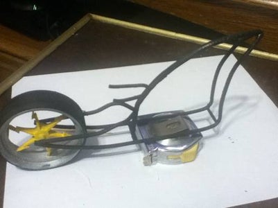

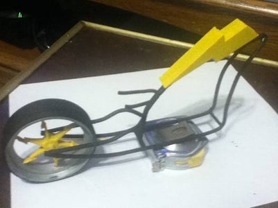

Step 13: Final Assembly of Parts
This is the final step in building the motorcycle. First step is start by taking the frame and putting all the parts on. This will show what the over all look of the bike is and how you will need to space everything to fit perfectly. Once you have done that you can take piece by piece off and with the super glue, permanently securing the parts down. For the wheels you might need to make axles to secure them. For my bike I drilled 1/32nd inch holes and with a piece of wire I glued them in place. When the whole bike is secured together you have a couple options; you can secure it to a enclosed case that AMT models makes, or you can create your own like I did with some foam core (found at staples) and some plastic.

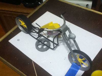

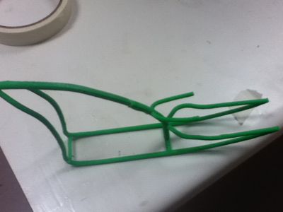

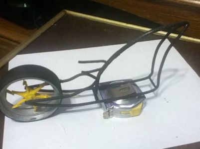

Step 15: Other Bikes Made
The following pictures are examples of 3 other people who I have seen complete the project. One is a chopper, one a concept sport bike, and the last a concept scooter design. All of these have been created using the same steps and process I have shared in this instructable.
