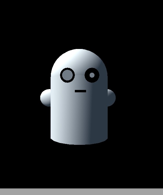

Your Game Tab Window should look similar to this.
