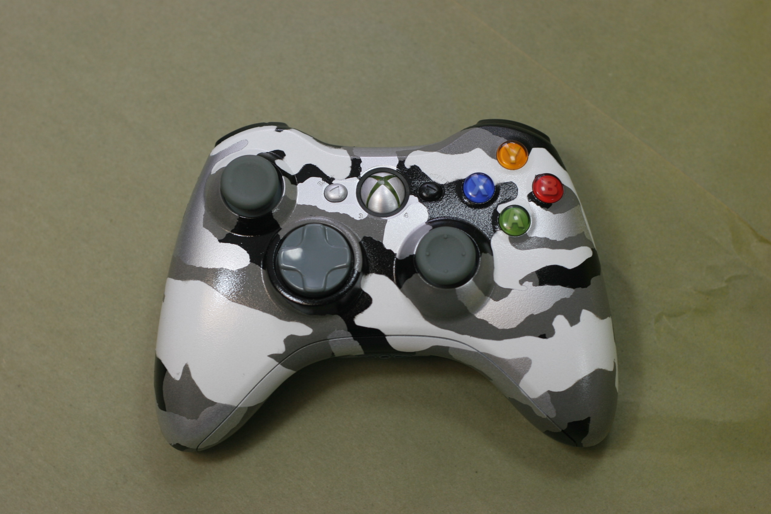

Introduction: How to Disassemble an Xbox 360 Wireless Controller
This is a step by step tutorial on how to disassemble an Xbox 360 Controller for painting.
Painting the controller takes time and effort and if you prepare the controller correctly, great things can happen.
