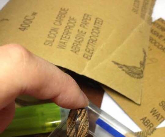

It is always dirty and messy when we Diy something on your worktable. If there is a mounted underneath the table small drawer like garbage, broken skin shredding thread entered swept away and keep the table clean. You can even put commonly used tools in a drawer,and do not heap full table full of walls. Here I’m going to teach you how to diy a small drawer to recycle garbage for your table.
