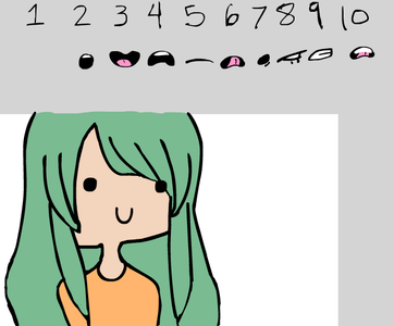

First of all, we need to draw the mouths for the animation. Draw them above the stage. Also, as a little trick, draw the mouths with the characters personality in mind. If they're lazy, perhaps make the mouths small to make them appear to be mumbling. Or maybe they're very energetic all the time and wider, more open mouths would be better suited. Take mood in to consideration too (ex. mouths slanted down for sad). Also, when choosing the mouth shapes, remember that people don't all talk the same and that for some sounds one person will make a different mouth shape than others. So, really there is almost no right or wrong way to draw these mouths. I will, however, include a chart for reference based on the way I personally speak. After you have drawn the mouths, I would label them. This will help you after you convert them later on.

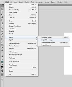

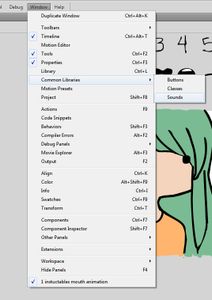

I highly recommend to import the sound into the program before you start to lip sync the characters mouths. This will allow you to hear the sound at the exact millisecond it occurs in, which will be of much help, let me assure you. This step is quite simple. Go to File>Import>Import to Library. To retrieve the file you just imported, go to Windows>Common Libraries>Sounds. Then, simply drag your sound files onto the stage and viola, you have imported the sound. The good thing about doing it this way is that the sound files are now stored there and if doing sound effects or such, you wont have to re-import them. You'll simply go to the sound library and drag them onto the stage again.

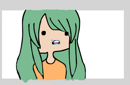

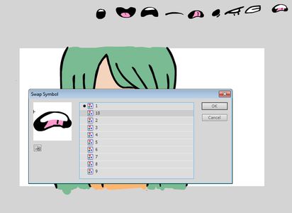

First things first, you take the first mouth you wish to have in your animation from the labelled graphics and drag it down to where you wish to place it on the face of your character. Easy enough, right? Next, locate spot on the timeline where the next sound occurs. Add a key-frame at this spot (press F6 or add manually).Then, choose which mouth you drew would best fit this sound and right click the mouth you dragged onto the face of your character. Then, choose the 'swap symbol' option. A small screen full of the different mouths you drew and converted will pop up. Simply choose the mouth you want from this list and hit OK. And presto! You've replaced your mouth. Also keep in mind that if the animation isn't smooth enough for you, just draw some in-between mouths and use more key-frames. Simple as that. Do this for the rest of the sounds in your sound clip and you'll be done in no time!
