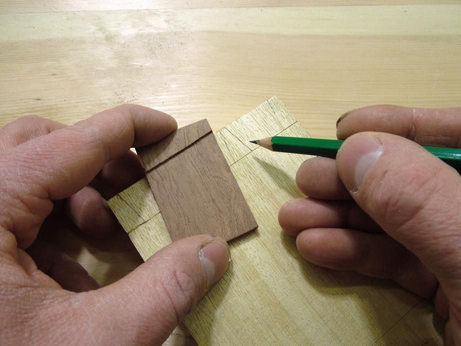

Set dividers to 1 tail +1 pin. Start from the half pin marks walk them across the work leaving a light pin mark.
Step 7: Square
Using the square mark a pencil line across each divider mark.

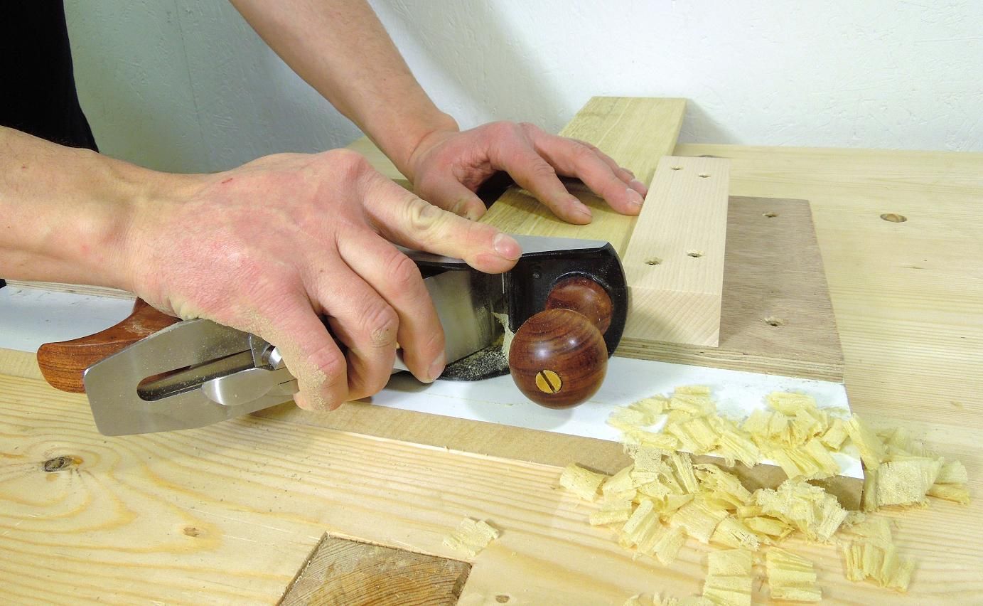

The tail board is the template for the pin board. Secure the pin board in the vice. Use the plane to level the pin board. Rest the tail board on top. Use the plane to support the far end of the tail board. Line up the base line of the tails with the pin board and make sure the ends of the tails are flush with the pin board. Secure the tail board by applying downward pressure (use clamps if you want). Use the marking knife to create the outline of the tails. Remove pin board, square the lines, mark your waste.
