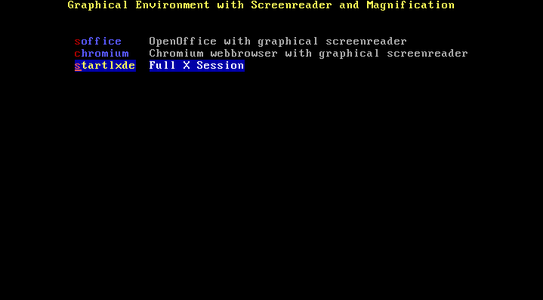

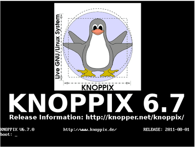

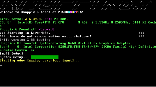

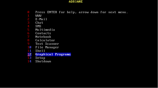

Now, you will need physical access to the person you want to prank's computer. Boot off of whatever device you have decided to use. The pictures above will show how to boot Knoppix into a full X session.

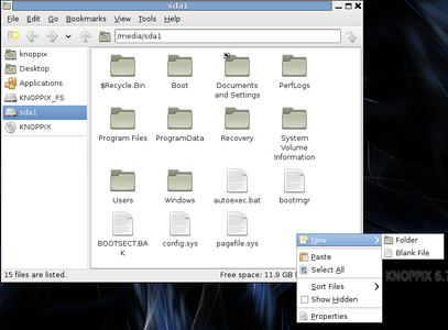

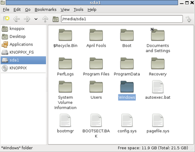

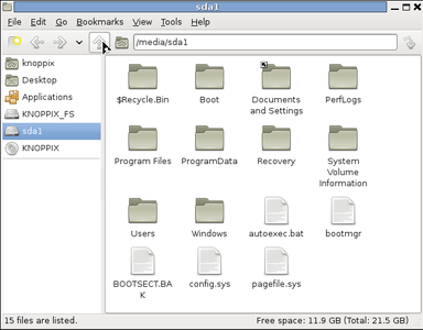

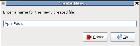

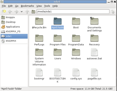

First you will click the "Knoppix" folder on the desktop. Then you will select the hard drive that your Windows system is on. Usually this is sda1, but make sure you can see the Windows folder so that you know it is the right hard drive. If your victim dual boots, then you might have to do this to more than one hard drive. Then right click a blank spot on the window and select "New" then select "Folder". Name the folder whatever you wish, but remember the folder name for when you are ready to recover the computer. I suggest using "April Fools".

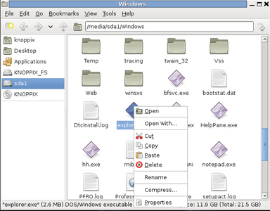

Now this is what really makes the prank work. You will navigate to the "Windows" folder, and move the "explorer.exe" file to the folder you just created.

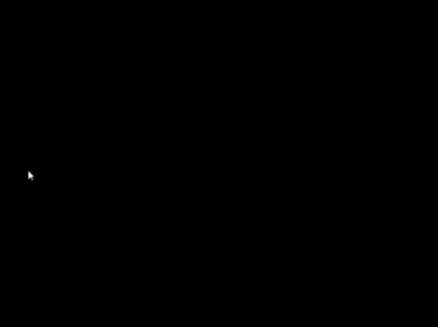

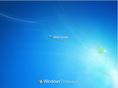

The victim's computer will boot as normal until they have logged on. After they log on, it will freeze on the "welcome" for a few minutes, then it will display a black screen. I'm not sure if this is the same on every Windows system, but no matter what, the system will not boot.

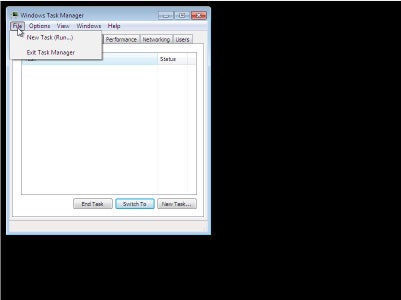

Pranks are fun when you know when to stop. Be sure to help your victim repair their computer. The simplest way that should work on most distributions of Windows would be to start explorer from taskmgr and move the process back from Windows, however, some distributions will not want to start taskmgr at this point, in which case you need to reboot back into Knoppix and move the process back into the Windows folder.

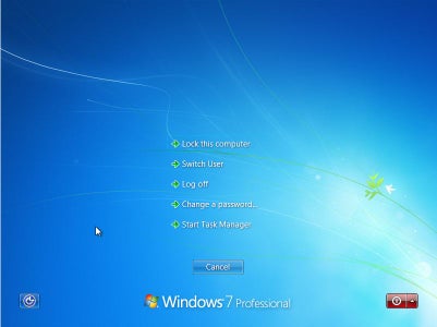

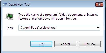

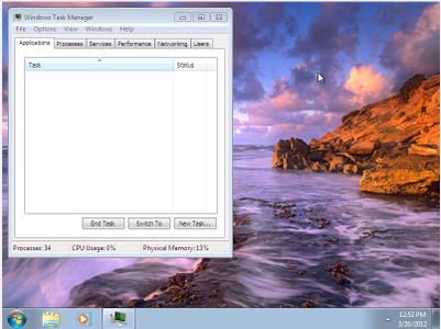

To use taskmgr, press "Control"+"Alt"+"Delete" together, and if prompted click "Start Task Manager". Then click "File", then "New Task (Run...)". In that window, type the path of the process (if you used the "April Fools" folder, it will be C:\April Fools\explorer.exe).
Your computer should look like it normally does now (except for the taskmgr window open... you can close that now).

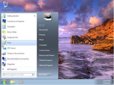

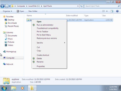

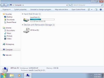

Click "start" then click "Computer" or "My Computer" (depending on your OS... only one will be displayed.) Then double click your "C:" drive. Double click the "April Fools" folder, then right-click the "explorer.exe" file. In Windows 7 you can just move the file, but I'm not sure about previous versions, so try clicking "Cut" first, but if it gives you any trouble when you try to paste, go back and use "copy".

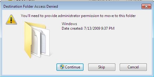

Navigate to the "Windows" folder, then right click a blank spot on the window, and then click "paste". On Vista and 7, the UAC will ask you at least once to confirm that you want to paste. You do want to confirm this.

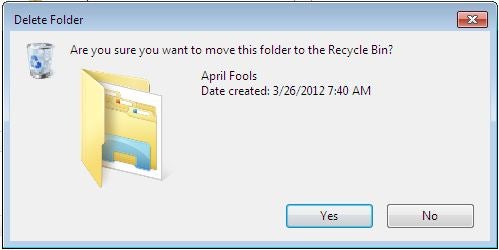

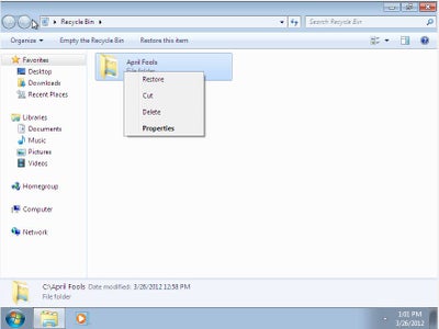

Now go back and delete your "April Fools" folder, and remove it from the Recycle Bin.
