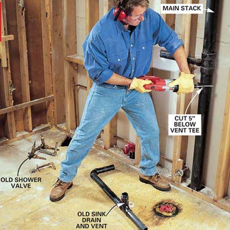

The special-order fixtures, fittings, shower pan, tile and glass block panel can take weeks to get in hand, so do the necessary legwork and ordering well in advance. Before gutting the bathroom, check to make sure that there are shutoffs for all the fixtures or a master shutoff for the entire bathroom. If not, buy ball valve shutoffs sized to fit your pipes. Then turn off the main water supply line where it comes into the house from outside, cut the pipes feeding the bathroom and install the new shutoffs right away (see Photo 7).
Disconnect the trap from the tub, remove any clips, fasteners or screws that hold the tub to the wall, and demolish the old cast iron tub with a sledgehammer. Remove the sink and toilet. Turn off the electricity at the main panel and remove light fixtures. Cap the wires with wire connectors. Then rip out the wall finishes and surfaces clean down to the studs and pull out any insulation. If your ceiling is in good shape, use a utility knife to cut the drywall along the edges so the wall materials will separate cleanly from the ceiling.
_________________________________________________________
