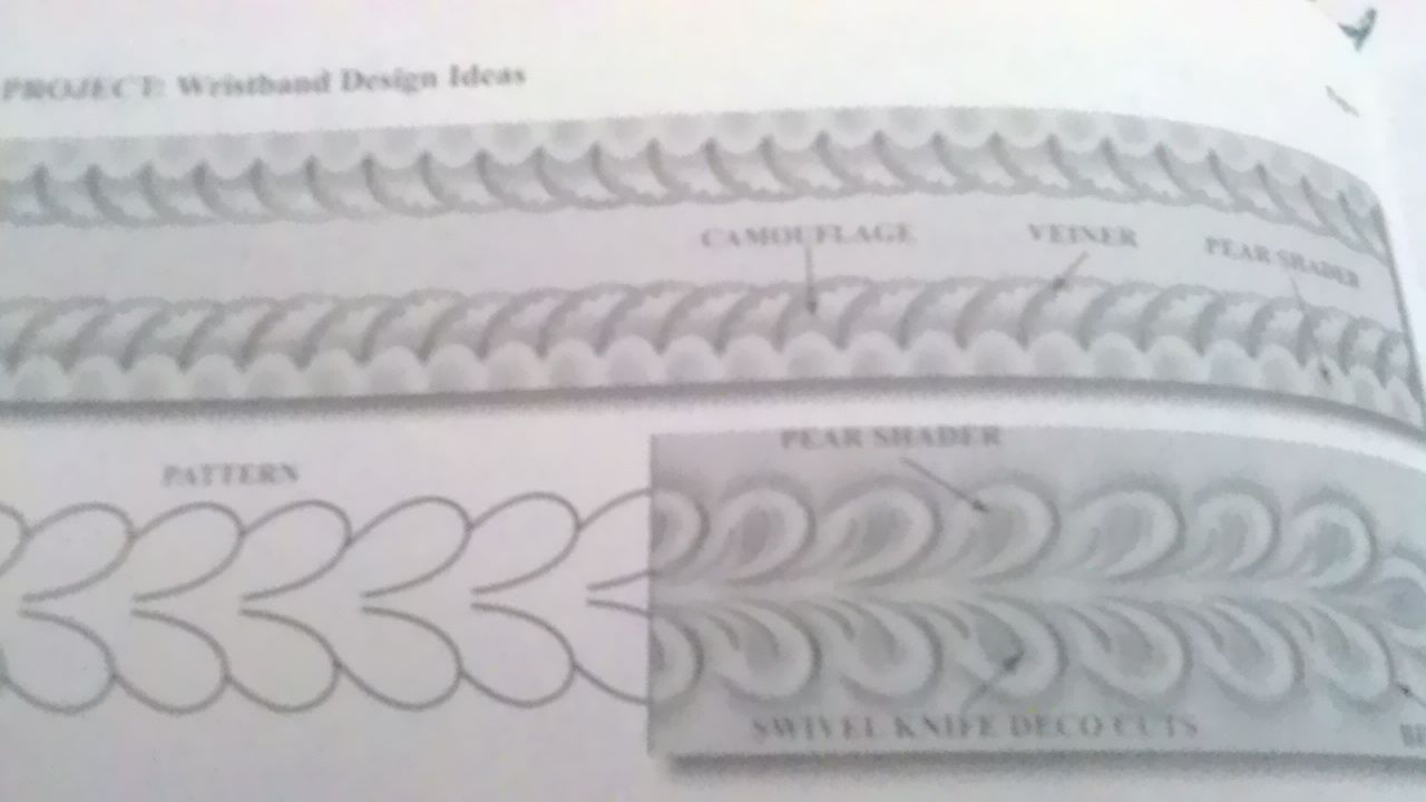

Stamps: Veiner, Seeder, Camouflage

Take your swivel knife, having it straight up and down tilted slightly away from you, and pulling it towards you. Go over the lines in the design, being careful if the lines are close together.
Step 5: Step 5: Stamps
For this step you will need the stamps from the material list. Stamps will be straight up and down, sometimes tilted left or right.
