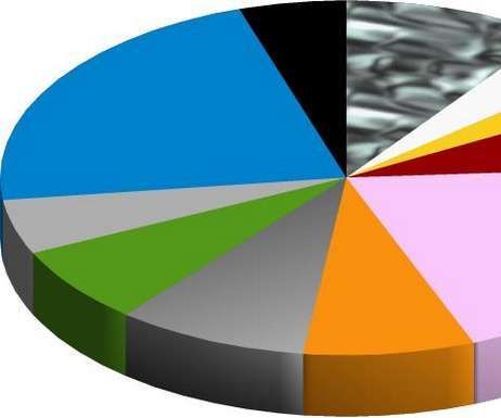

Bar graph is instantly created, although it looks weird. Data for years is not used in correct place. We'll correct this, but first let's select a bit more fanciful look: shape of cylinder instead of default bar and addition of 3-D effect.
