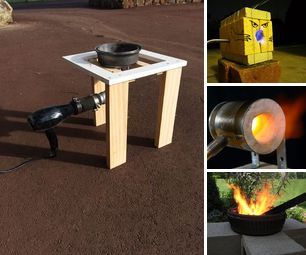

In this Instructable I am going to show you how to make a brake drum blacksmith forge.

Step 2: Connecting the Pipe
The pipes should be arranged as per the above picture.
Step 3: Connect the Brake Drum
Connect the brake drum using bolts, nuts and washers.
Step 4: How It Works
The forge gets hot because the hair dryer blows air constantly into the fire.
Step 5: Finishing Up
Connect the hair dryer to the side of the forge and then tighten the clamps. You could use either charcoal or if you have coal available you could use that. I made a stand out of some wood but you could make a stand out of cinder blocks if you don't have any wood available.
