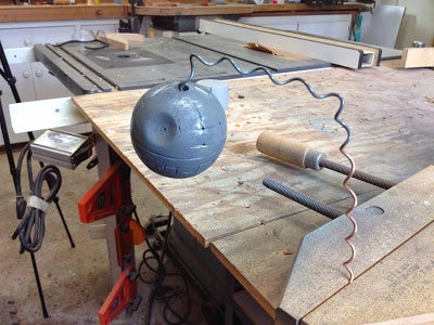

Next was to use the jamb chuck to allow me to dish out the planet cannon portion of the battle station. The crux of the Death Star. I then took out my Dremel and cut a bunch of metal plates impressions into it. I think it worked for what I was looking for.
The last step was drilling out some holes for the light to shine in. I believe the bit I used was 1/8. Then simply paint and add whatever highlights you want! It's ready to hang on your tree. Or not.
