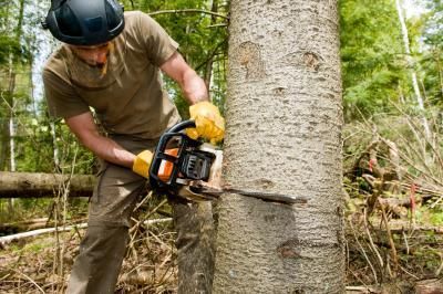

Step 1: Cut Down the Tree
First you want to cut down your tree, obviously. This is pretty self explanatory, if you need a reference here you go: http://www.familyhandyman.com/landscaping/how-to-cut-down-a-tree/view-all Be sure the tree is at least 1' in diameter otherwise it will be really tough to bike across. I recommend around 2' width. For the length of the tree make sure it is about 2' to 3' longer than your gap. You can always cut the tree shorter later. I like to have extra length to ensure that the tree will fit correctly.
