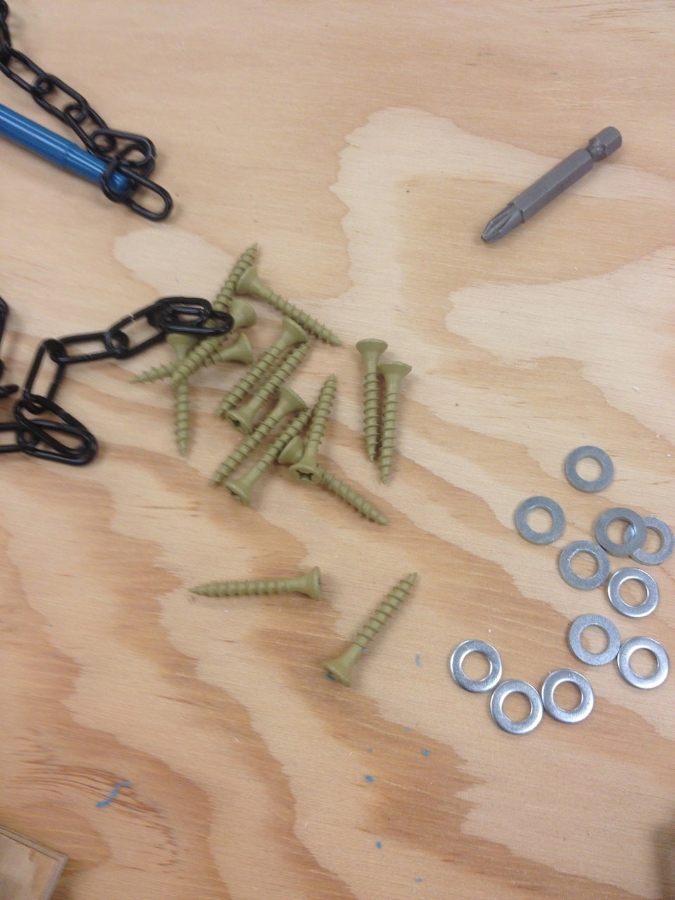

Step 1: Gather Materials
I used the following (your supplies may vary):
Small Notepads
Scrap Plywood, enough to make a few frames
Deck Screws; these serve to hold the notepad to the board; the board to the wall
Pens; Ball point pens with a substantial amount of material above the ink cartridge (room to drill a hole)
Chain; *VERY small*; about a foot or so, per board
Washers; to hold the chain to the board

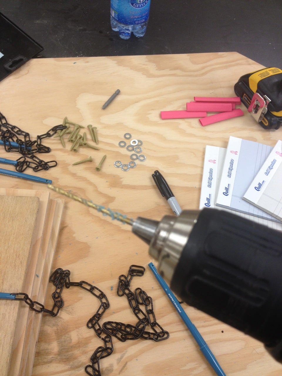

Using the drill motor and the appropriate sized drill, make a hole in the opposite end of pen, from the tip. Take care, this can be tricky due to the outer diameter of the pen being relatively small.

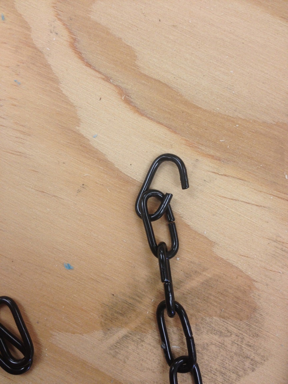

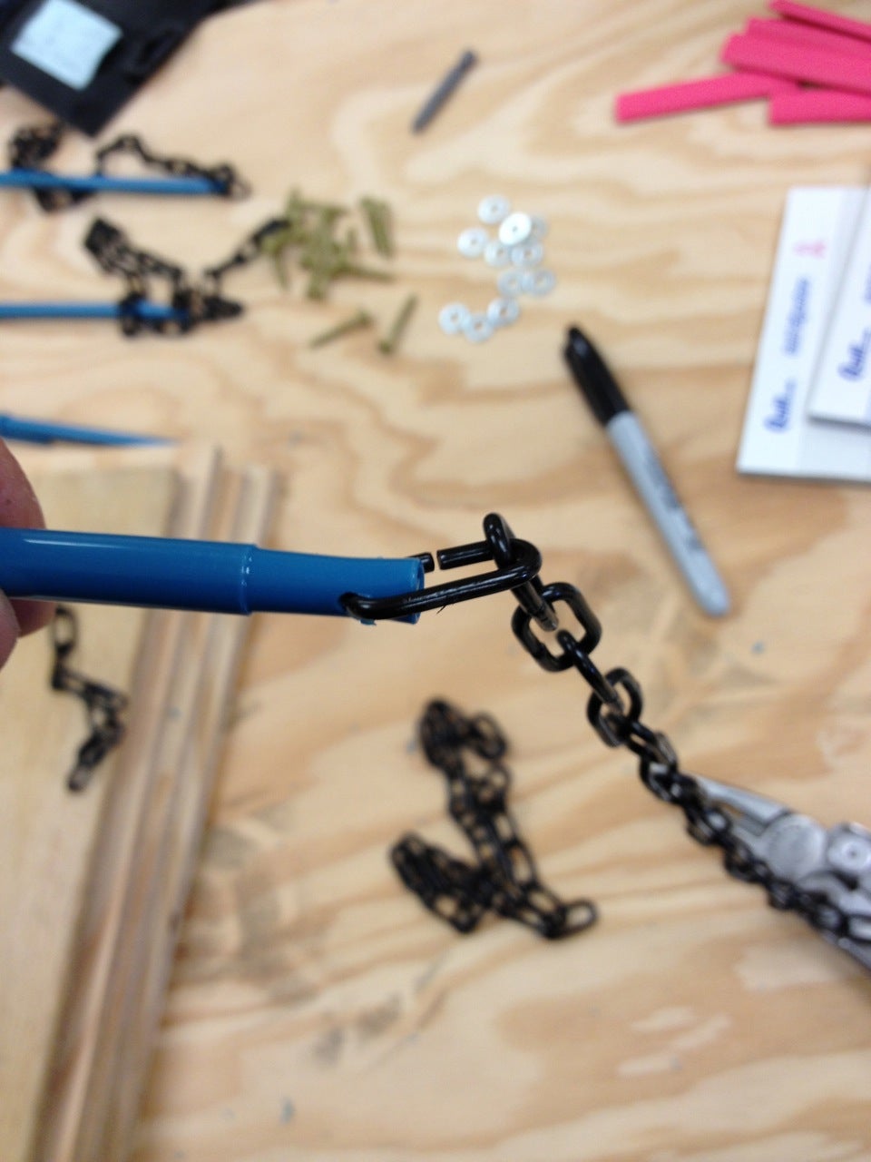

Using your Leatherman, pry open one of the chain's end links and slip the pried end through the hole you made in the pen.
Then, again with your Leatherman, collapse the pried open chain link back to its original (closed) state.

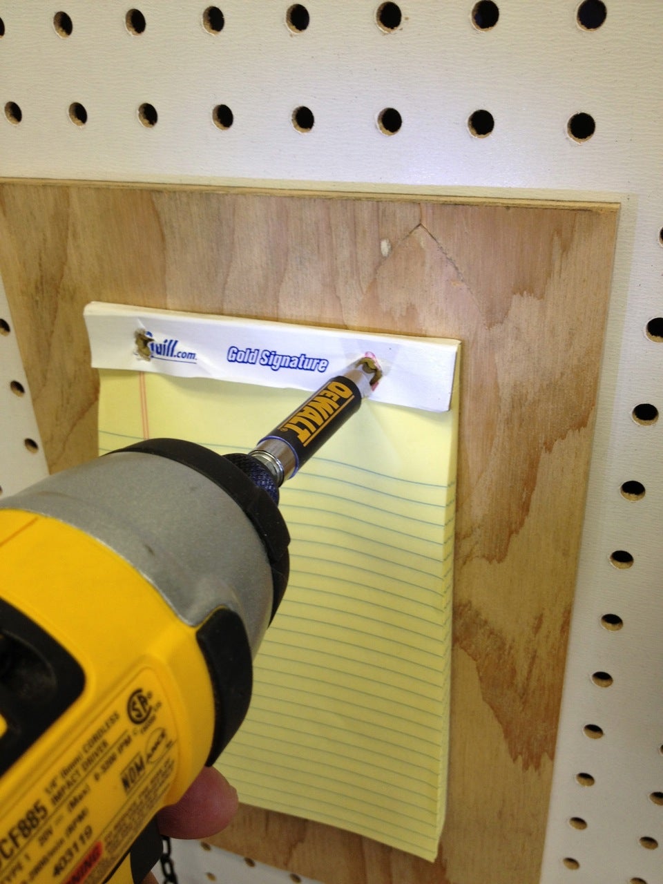

Step 4: Attach the Notepad to the Board!...

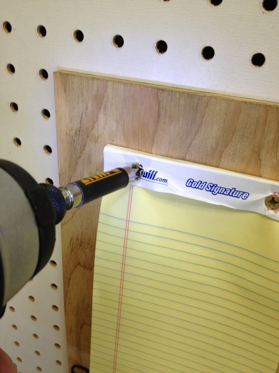

Using the power nut-driver, with a phillips #2 bit, take two of the deck screws and screw them into the header/binding of the notepad. At this stage you will not want to drive the screw all the way through the board! Just drive the screws in, until the tips *JUST* start to protrude from the back side!
NOTE: the actual length of the deck screws will depend upon the thickness of the notepad and the board, combined with the depth you want it to go into the wall/mounting surface. In my case, about 1 and a half inches was perfect.

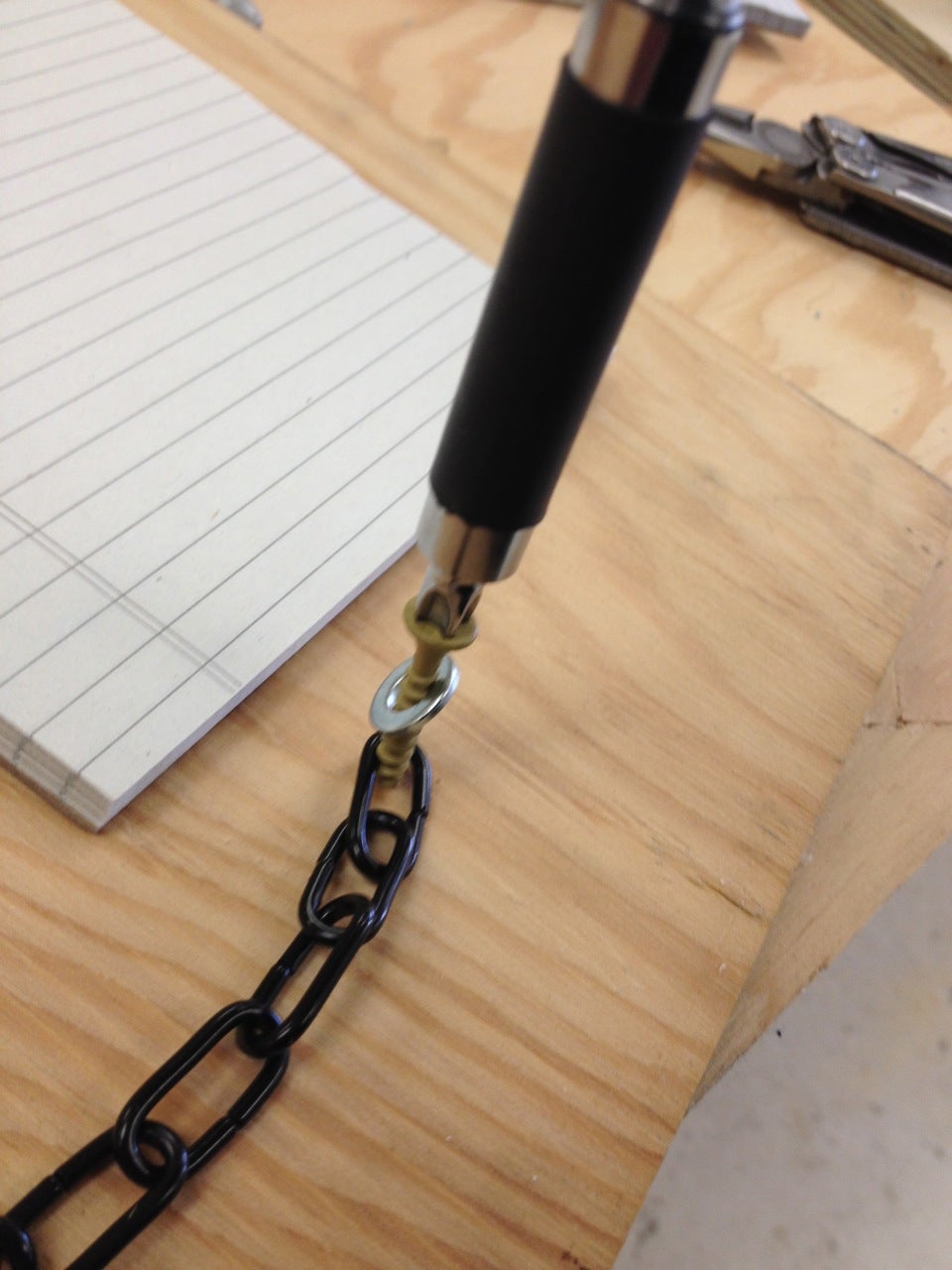

Take one of those handy deck screws and a small washer; using the power nut-driver, screw the chain down on the lower left corner of the board; unless you are a Lefty; in that case, screw it down on the lower right side of the board.
REMEMBER: do NOT screw it down all the way, yet!

Step 6: Mount the Suggestion Board to the Wall (or Other Appropriate Surface)
Now take your half screwed down Suggestion Board to the wall or surface you intend to mount it to.
Align the board for level and desired hight
GENTLY tighten down the two notepad screws in the binding, until they are flush but NOT over-tight! You will know they are too tight by observing the notepad; it should lay flat against the board.
GENTLY tighten down the one pen holding screw until is is snug; but NOT over-tight!
