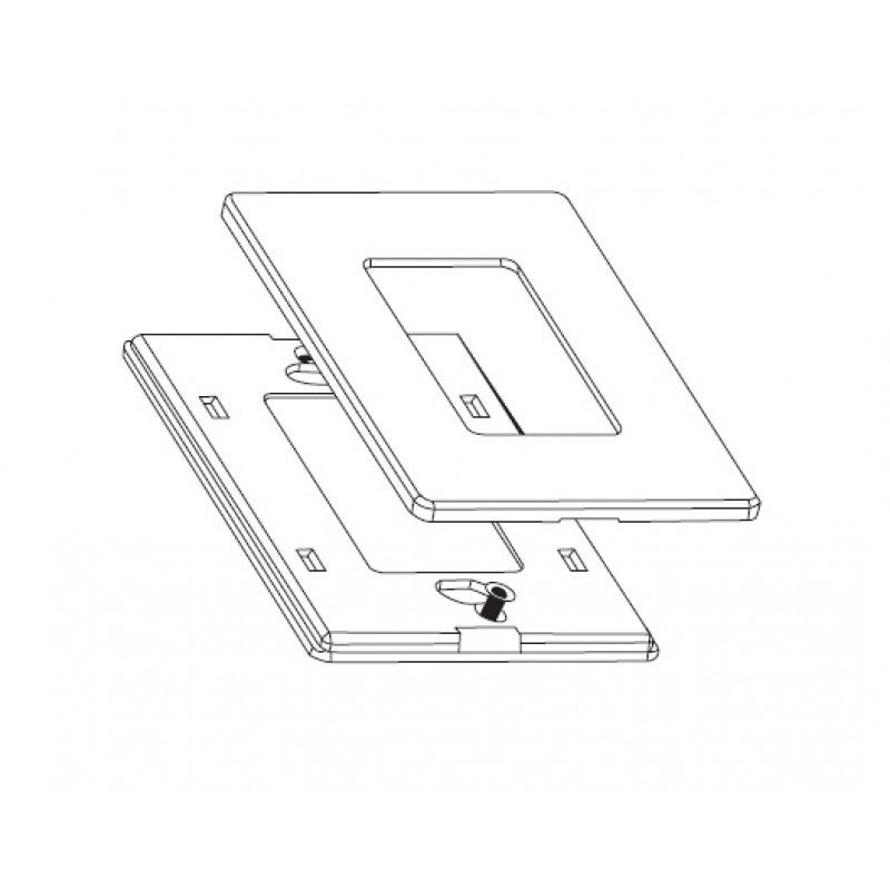

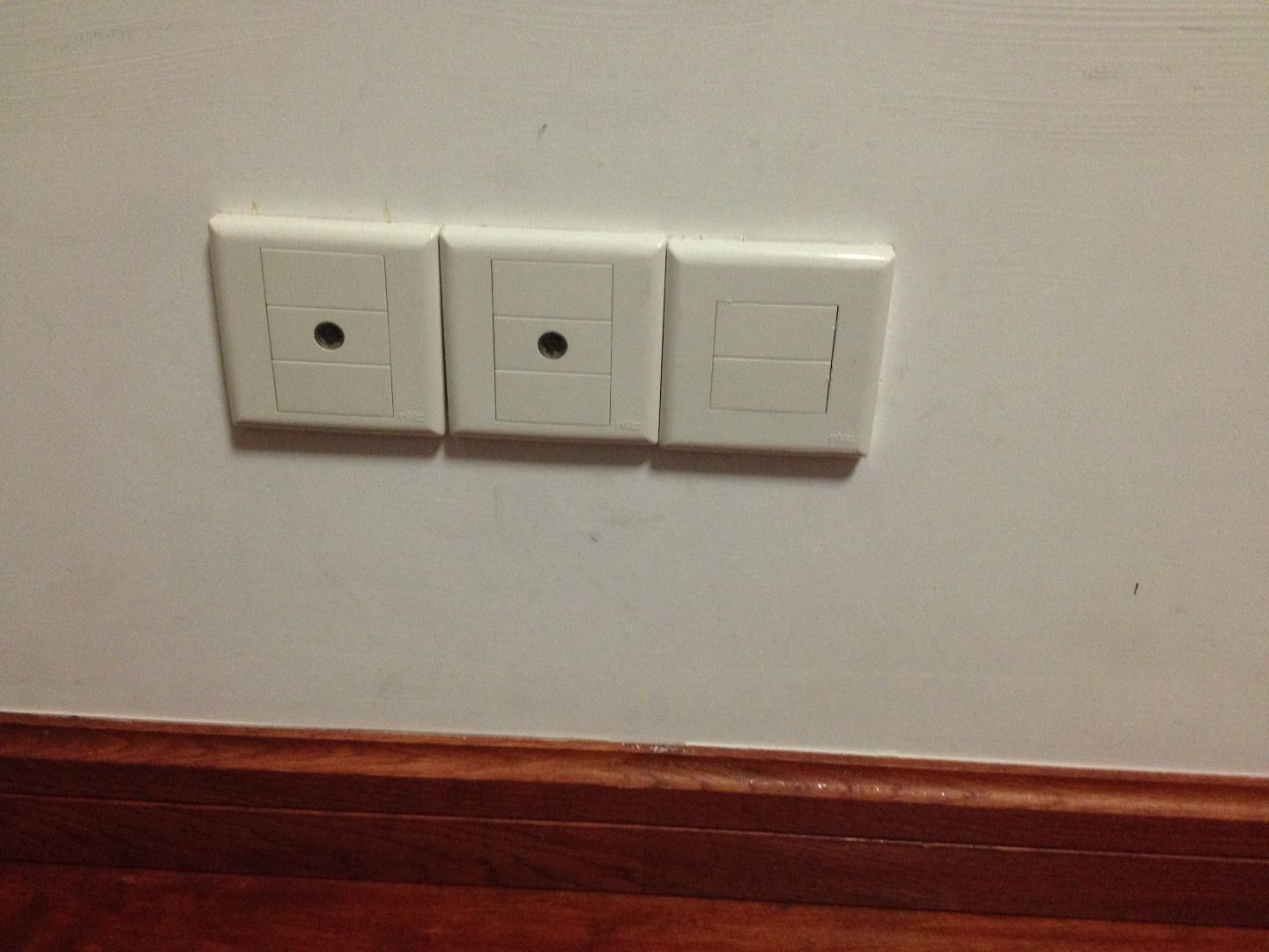

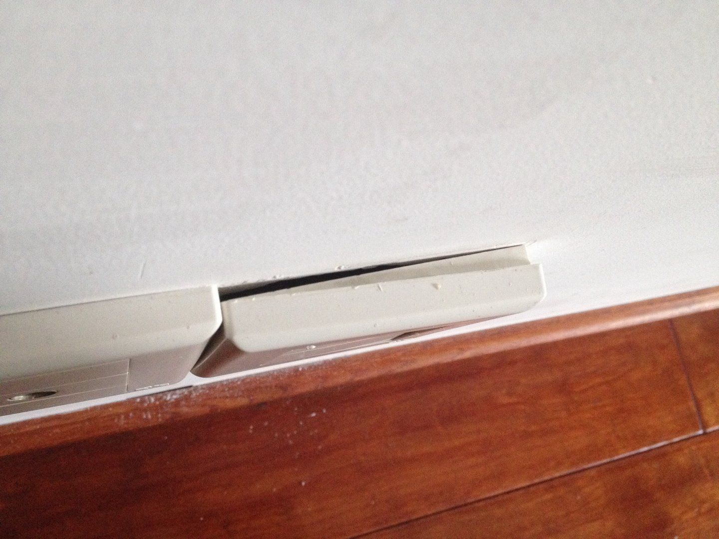

    I wanted to go with the cable jack option, but I just took a look and in my house all the electrical boxes have screwless face plates, is there any way of taking them off?
    0
    NoelV4
    NoelV4
    Reply 5 years ago
    the screwless outer trim just pops off. There is an inner piece that's held in with screws.

    I tried... :(
    After a lot of tries I managed to pop off one corner, but then when I did the other corner the outer rim was jammed with the inner ring and I pulled out the inner ring, on my outlet the inner ring does not seem to be screwed in place as it came off.
    0
    NoelV4
    NoelV4
    Reply 5 years ago
    That is not what I had in mind when you said screwless face plates. You have wall-mounted junction boxes. Though it could work with yours (for very tiny stashes) I think this instructable was geared toward traditional junction boxes that are recessed inside the wall, with plates that are mounted flush on the wall.
    Can you post a front view of those wall-boxes?
    These are the screwless plates i was describing:
