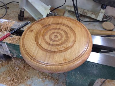

This is a 10" maple disc that I turned on the lathe and used a 1/8 inch bench chisel to cut the grooves.
