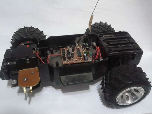

- An Old RC Car

Step 2: Get the Motor From the RC Car
we will get the motor from the RC car's gear box ,take the motor out from the gearbox using the screwdriver and remove the motor's gear.
