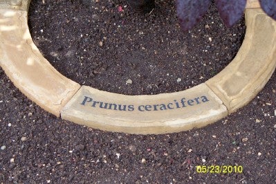

Step 9: Personalize or Decorate the Form
Here, I have cut out some letters of eps foam on my hotwire machine. For a complete tutorial on making letters from eps (styrofoam) go to www.instructables.com/id/Hotwire-magic-The-Art/ . This picture shows the name of the plum tree: Prunus ceracifera. The other pictures show another possibility: make the message a memorial note. A good way to remember someone or a pet, perhaps, is to plant a living memorial such as a tree, and placed their name on the tree ring. These should last for a very long time.

Step 11: Place Ring Around Tree
The final step is to place ring around tree. I think it adds a lot to the appearance of the garden and sets the tree off very nicely. Thanks for reading my instructable.
